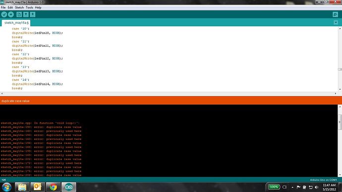

I had project for School language lab service
and right now because the schematic is lost I must build again from scrath
but without changing the control panel
my problem is
the control panel using 4x10 momentary switch to control the student equipment
so I'm using arduino mega to solved it
below is my code even though isnt finish yet

it show error in compiling, as picture attached
I guess I need to change the library
I see one of people has already changing into 5x4 keypad
but I tried and fail
below the code for library that I change

and it shows error
need help here
comment or suggestion is appriciate
thanks
