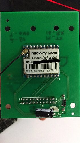

Hi.
I'm trying to set up the Neoway M590 module with presentation ycc-8 GPRS, but I'm having trouble getting it to work. The tutorials I found do not cover the problem and most are in Russian. Could anyone guide me with this module?
Error: When I send any AT command through the Arduino's IDE serial, the response is made up of strange characters such as squares and parentheses.
  • Powered it with external source 5v connecting the gnd of the external source with the gnd of the arduino.
  • I already tried to send the command through all bauds of the serial and the answer is not readable.
  • M590 pin 14 -> Arduino pin 2
  • M590 pin 16 -> Arduino pin 3
  • M590 pin 2 -> 5v external source
  • M590 pin 4 -> external and Arduino gnd
  • The red led (D1) of the module is blinking.
I got it!
After many attempts, I got a very unusual frequency, different from all the examples I found on the internet. 57600 baud.
The code that resulted for me was:

Tutorial that helped me:
Hope it helps someone else.
