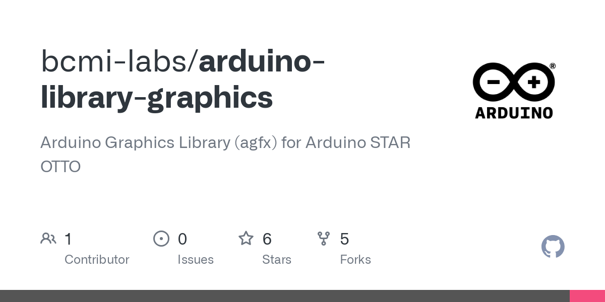

I found one library for "Arduino", but have not yet found out for which package this library is.
A closer look reveals it is for STAR OTTO, so this is one more thing for me to learn about.

STAR OTTO looks interesting, too, but what is the state of the project, is it available?
I installed the package, but get strange error messages when compiling with the above library:

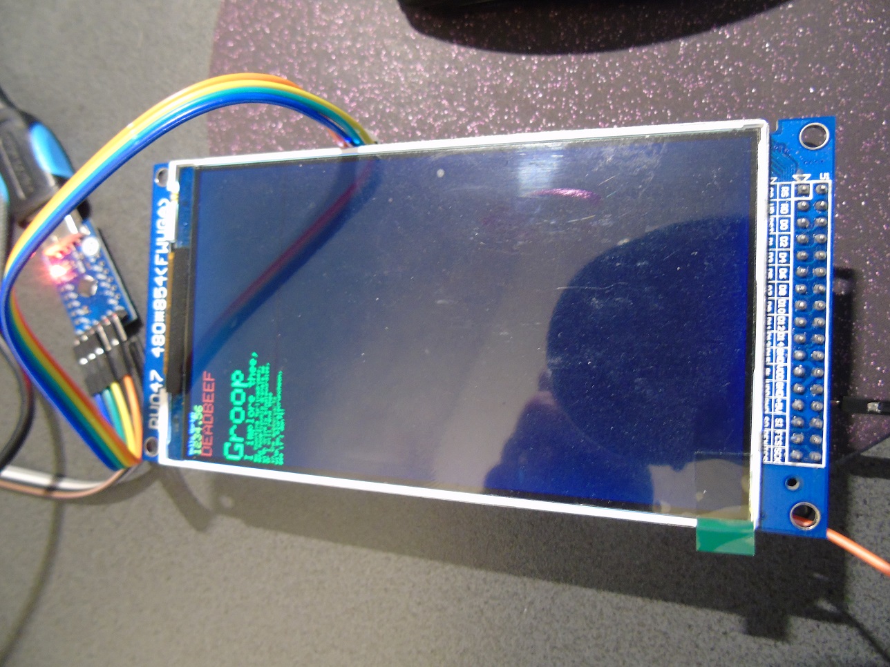

Unfortunately the pinout of my TFT does not correspond to the black STM32F407 boards.
Go on. You have experience with an SSD1963 and 8080-16 interface.
Most MIPI controllers will start up by themselves. Ok, you might want to adjust Manufacturer Power and Panel registers.
I have no knowledge about Star Otto.
David.
Thank you David! Yes, of course I continue. My post helped me on the way to get ideas.
The inking on the board at the side of the connector is a bit hard to read, but I found out that most pins correspond to the pins of my 5 inch "Tiky" display, from same supplier.
So my first wiring will be through a long tail connector with some bent pins to the STM32F103VT6 board that matches with the "Tiky" display.
And so, as I had hoped for, I found another display that matches (nearly) to a FSMC connector, but not for the board I had in mind.

As I may have contributed to the confusion about STAR OTTO:
  • is seems not yet available for the general buyer
  • it is from Arduino.org, which is NOT the same as Arduino.cc, and has its own Forum:
see also: Hands-on with the Arduino Star OTTO Light - General Discussion - Arduino Forum
This display matches the FSMC TFT connector of the STM32F407ZG-M4 board:
STM32F407ZGT6-Development-Board-ARM-M4-STM32F4-cortex-M4-core-Board-Compatibility-Multiple-Extension
But needs addition of 5V to the 5V pin for backlight (NC on STM32 board).
It needs 16bit command transfers, named "(MDDI/SPI) Address" in some version of OTM8009A.pdf
I received driver source examples for STM32 and C51 from the supplier.
And added the controller class GxCTRL_OTM8009A_RV047 to my GxTFT library.
This controller class is display specific because of the special init sequence and 16bit commands.
