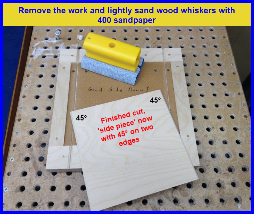

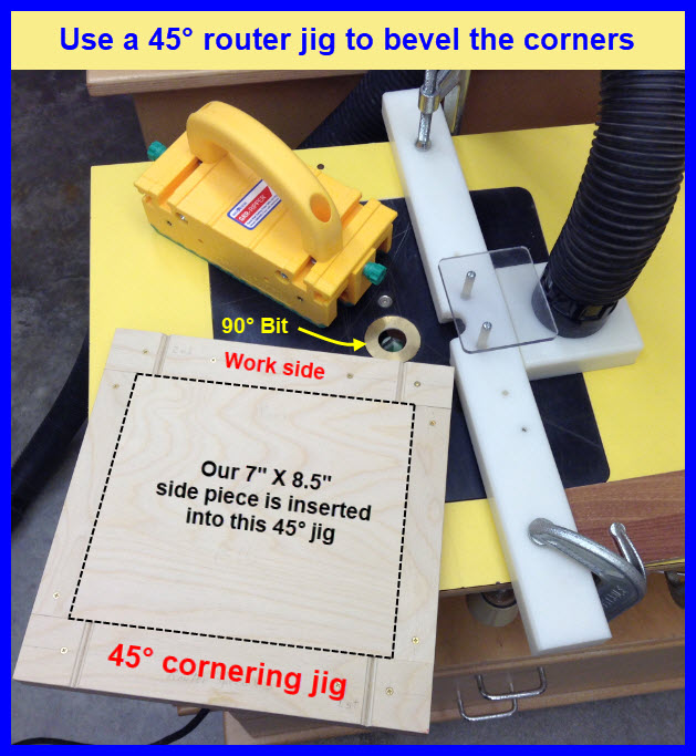

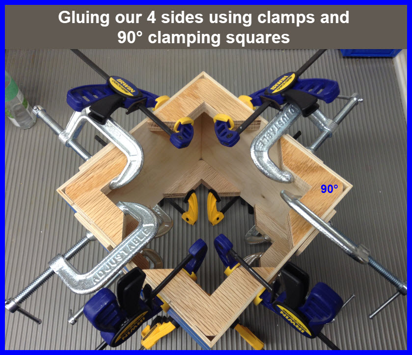

4 AA batteries used in this example.
> [@Share tips you have come across](https://forum.arduino.cc/t/share-tips-you-have-come-across/428745/808):
> Flush cut, down cut, spiral router bit.
