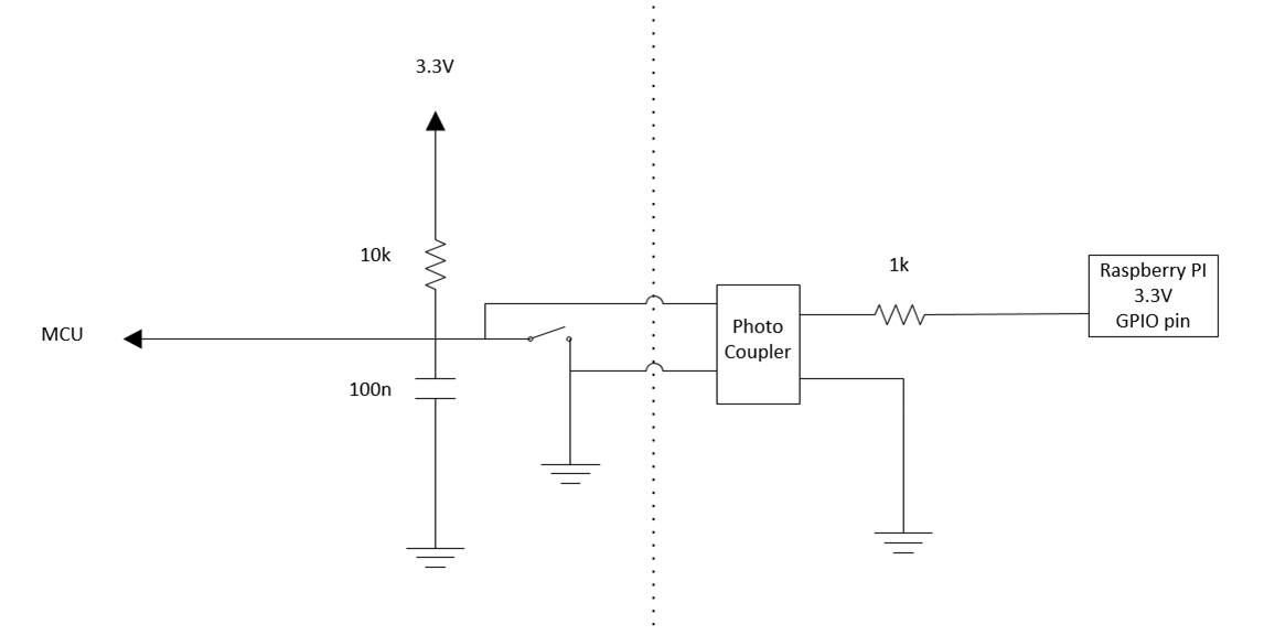

I have tried to search and find a solution to my hobby project. I think I have found a working soluton, but would highly appreciate a second thought.
I want to control a button both by pressing it and activating it with my Raspberry/Arduino GPIO. The coupling needs to be opto isolated.
Image1 shows the circuit I want to extend. Image 2 shows my proposed solution.
Would be happy for any comments. And I also need advice on which optomos/photomos to buy for this purpose. I need both Normally Closed and Normally Open versions of the component.
Edit: For now I just need advice for a suitable NO Optocoupler

Optocouplers are usually Normally Open. Explain why You want Normally Closed?
You are right. I will probably only need NO Optocouplers. But in my project (read: in my noob brain) I think maybe there will be use of a NC solution if there is a situation where interrupting the current triggers an event.
Thank you for addressing this. I will just need advice for a suitable NO Optocoupler for now :slight_smile:
Just search on Internet. Ebay surely have such devices, Amazon...… If You have more local suppliers, check them up.
Using low voltage and low current almost everything will work.

The Transistor Output Optocouplers ought to work. There is a category of High Speed/Logic Optocouplers in case of high speed.

I've used some old Sharp PC815.
Close, neighbour :slight_smile:
Didn't find the Sharp, but I think EL817 looks promising ?
https://www.elfadistrelec.no/en/optocoupler-dil-35-everlight-electronics-el-817/p/17539000?q=&pos=1&origPos=1&origPageSize=10&track=true
Regarding speed I think 4 µs is fast enough for me. But thank you for pointing that out :slight_smile:
I couldn't any respose time, Your 4 Micros. Where is there "a 4 mikro second"?
That device is likely good for You. Buy a few!
I was thinking about the rise and fall time ? But that might be the wrong "timer" .. I noticed the rise and fall was significally lower on the high speed ones.
Thank you very much for the help, Railroader. Karma given :slight_smile:
Thanks! Good luck finishing Your proj.
If you are putting your circuit in parallel with a physical button, transition time is not really relevant. How fast do you think a human pushes a button? Do you really plan on "pushing" this button thousands/millions of times a second?
