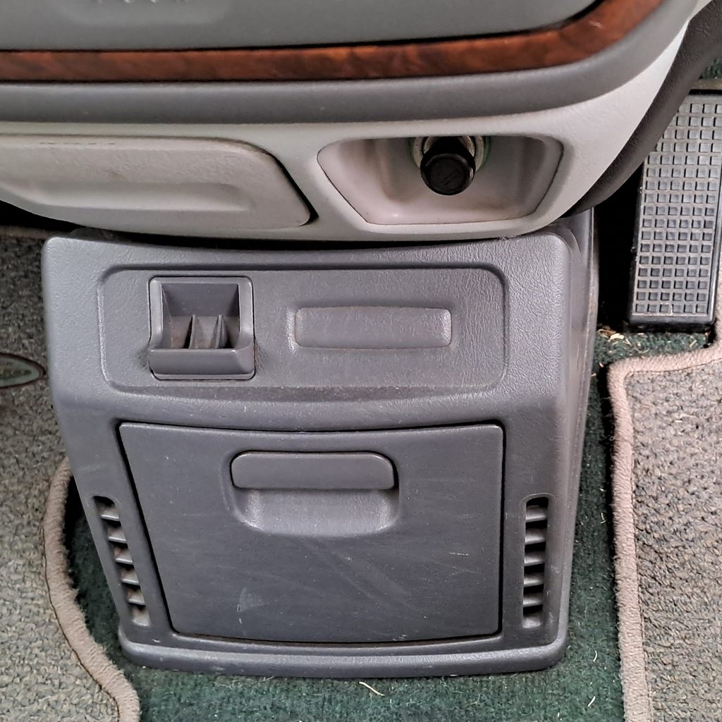

A bit of background: My old Mitsubishi Delica has an LCD odometer display; over time the LCD has started to weep and is now barely visible. I'll blame the Aussie sun. :grinning:
The Delica gearbox has a sensor that generates 2550 pulses per kilometre; so it was easy to tap into that and derive a square wave using a schimitt trigger to apply to a GPIO pin on an MCU.
My first attempt used a Wemos D1 mini and an SSD1306 display. I stored the pulse count in the Wemos EEPROM. Because the Wemos was slow I only updated the pulse count every 0.1k. Unfortunately I didn't read the small print - EEPROM on the Wemos is simulated in SRAM. After 10,000klm the memory died. I upgraded the sketch to step on to new memory addresses every 10k.
Then I saw the spec of the TTGO T-Display and decided to write a more robust sketch taking advantage of the dual core processor and faster clock speed. I also got a 32kB FRAM I2C breakout board to store the odometer data. I plan to use the 32k to store a service schedule and prompt the driver when services are due.
The sketch uses the one button on the TTGO to reset the trip and the other button to toggle between test mode and on road mode. The test mode simulates the car driving at 100kph.

Hi, I'm all good , I hope you are too.
It seems to be a common fault on the L400. All the secondhand instrument clusters either have the same fault or have far too many kilometers on them.
The LCD in the instrument panel can't be replaced so you have to put the replacement in an enclosure and mount it somewhere on the dash. There are a few mods you have to make to hook it all up. The speed sensor is on the front of the gearbox and has a red/yellow wire running to the dash. The sensor generates 2550 pulses per kilometre.
There is a good instruction of the Delica Club website showing how to remove the cluster and the speedo pulse connection is shown in the photo below.
You will need to make up a circuit board with a 12v to 5v regulator on it. I use an LM7805 which is overkill - it can supply 1A @ 5v. I tried an LM78L05 it can supply 100mA but the ESP32 draws more than that at startup so it caused problems. In addition you will need a Schmidt trigger (I use a Texas Instruments74C14 IC) to convert the pulse sine wave to a square wave. I use that to trigger an ISR on the rising edge to increment the pulse counter. You will also need an FRAM breakout board to store the pulse count - any other type of memory will 'wear out' in about 10,000K.
The TTGO was handy being in a single package but I have gone to an ESP32 D1 Mini and a TZT LCD 1.3" connected via SPI. It's also cheaper.
There is plenty of room on the FRAM to store service data and I intend to display prompts for service in the blue square below the odometer readings on startup.

And you did place the TTGO under the cluster glass? or outside for have easy configuration?
The 7805 sounds good but it will not survive the possible transients in an automotive electrical system. You should look up load dump etc to see what you are against. There is also reverse battery and double battery jump to name a few.
If it continues to work reliably I will mount it in the coin slot space. I don't look at it that often but is quite visible there.
That was the reason for using a square LCD and the smaller footprint of the ESP32 D1 Mini.
