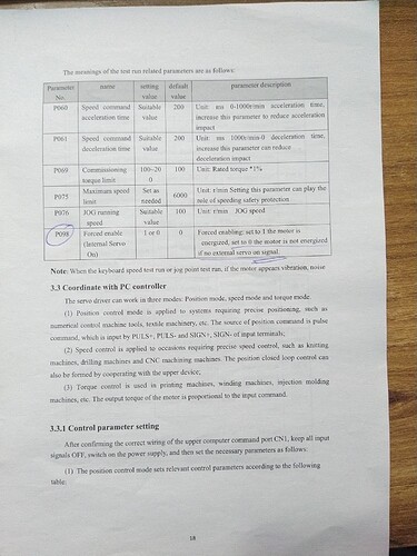

Hi, the servo i am using has a max rated rpm of 3000. It is set to 10,000 pulses per revolution.
Using the sample code with STEP and DIR, i am able to control speed and number of revolutions etc. and it works fine. We know that cnc softwares are able to have servos reach their rated max rpm. Question is, using Arduino, how can i reach a maximum rated speed of 3000 rpm using the sample code? so far using the following looping code, driver showing an rpm of around 653. Unfortunately it doesnt go lower than 1 microsecond. What method can i use in the code to achieve my goal?

There is no link for the driver, but these are the pages from the driver manual that mention something about rpm parameters....

there is a manual, i posted the terminals....
pins
Maybe scan it again and repost, so we can read it.
