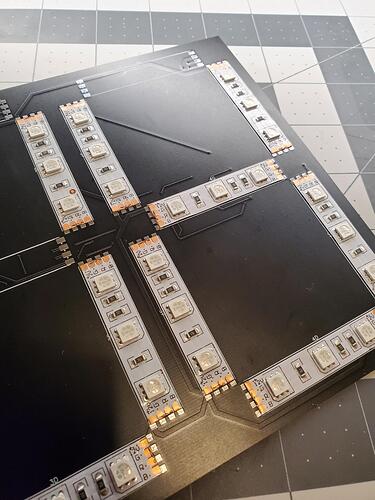

I have an RGB 7-segment display that I want to program as a clock. I designed it myself but did not realize the complexity of the code with the design that I have.
I'm going to do my best to explain everything so bear with me.
It has 6x 16-bit shift registers whose outputs are connected to short strips of those LED strip lights you can buy on Amazon. The main MCU is an Arduino Nano that is plugged in the back of the panel. (The shift registers are connected to the SPI pins so if i can use that it would be nice).
The problem I'm having is I need 21 bits for each digit. 7 segments * 3 colors. I have the data for the digits saved in an array:

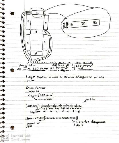

Here is a schematic on one page:
and a quick hand drawn diagram:
and a digit before soldering:
I think part of the problem is you are using shiftOut(), which only takes 8 bits, to shift out a 16-bit value. You will have to either 'createDisplayBytes()' into 12 bytes or use two shiftOut() calls for the two bytes of each 16-bit value.

johnwasser:
Thanks!!! I had switched back and forth so much that I forgot that the original verison of shiftout was 8 bits. sendData is my modified version of shiftout.
The LED's still dont light up in order with your program but thanks for it because I can use it for testing. I'm still really confused as to why your code lights up all the segments in a wacky order. I'm going to double check the schematic and make sure I didnt screw something up there. I do know that shifting out all 1's lights up all the LED's so I know theyre connected, but maybe something got screwed up halfway and is throwing everything off. (Should be connected how I explained but I am only human...)
I modified your code to also printout a representation of the bits being sent because it doesn't seem to work and I think this is because the last 12 bits in the last shift register are not connected to anything and its throwing off the order.
Here is the terminal output. (after using a program to flip left-right to put the first data sent on the right)

EDIT: I modified it to shift out
10000...000
01000...000
00100...000
00010...000
00001...000
and it operates as expected lighting up each segment in an RGB sequence. I just need a way to create all twelve bytes using the segment data. I have tabulated it all in Excel
In case anyone is interested in my most likely one of a kind solution, here it is.
I'm not sure what I had done wrong with the bit shifting calculations before but I rewrote the data and made a simple chart that told me what bits needed to go where.
