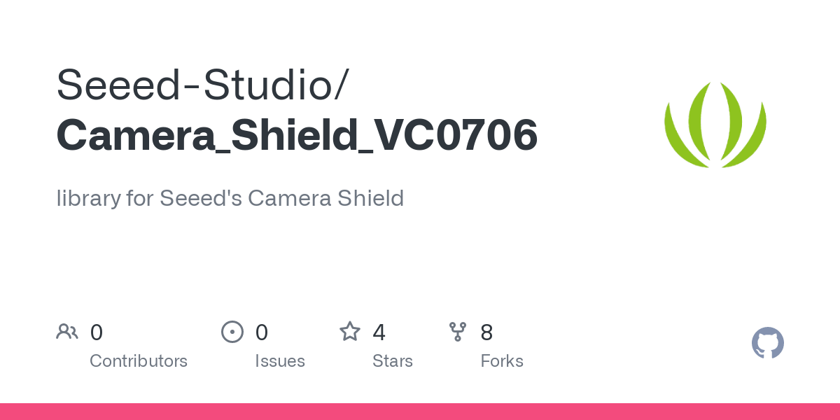

If you follow instructions given in the README of the Library to swap from softwareserial to hardwareserial, it should work correctly on a DUE.
Wonderful thanks for the link, I managed to get it working with this library.
