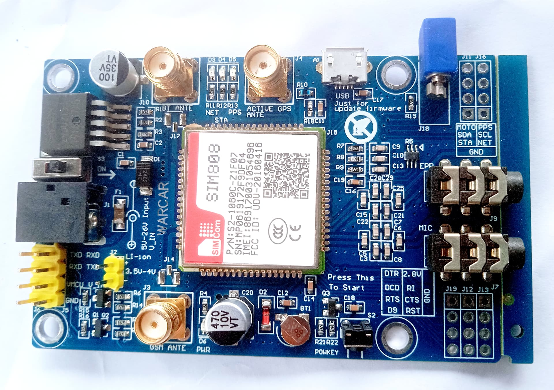

I have GSM SIM808 GPS/GPRS module and BMP280 Barometric Pressure Sensor connected to UNO.
SIMCOMM GSM SIM808 GPS/GPRS Module

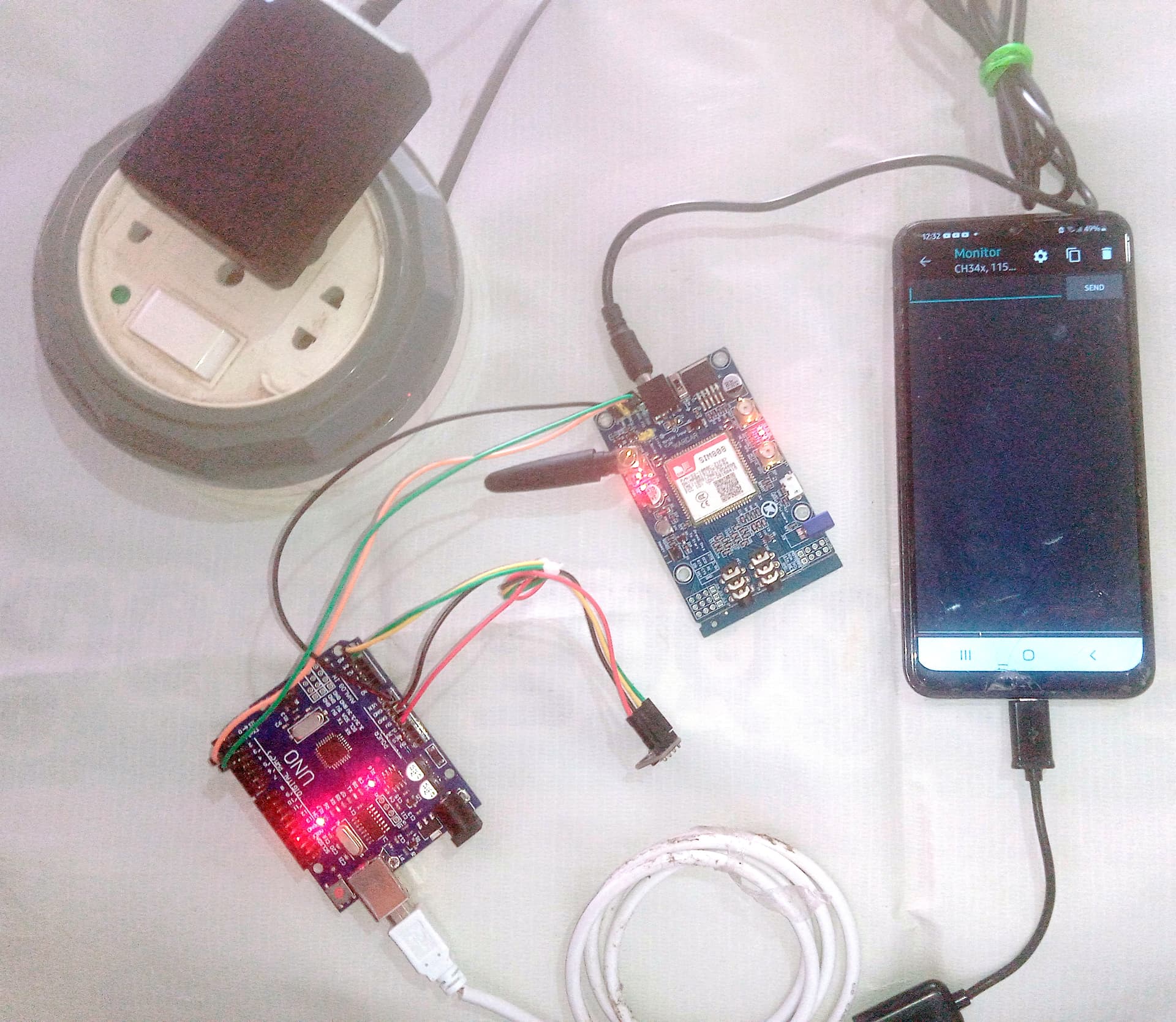

GSM Module and BMP280 Barometric Pressure Sensor with UNO
GSM Module External Power Supply
Pin Connections
GSM TX   - UNO GPIO2
GSM RX   - UNO GPIO3
GSM GND  - UNO GND (Common GND)
BMP VIN  - UNO 3.3V
BMP GND  - UNO GND
BMP SCL  - UNO A5
BMP SDA  - UNO A4

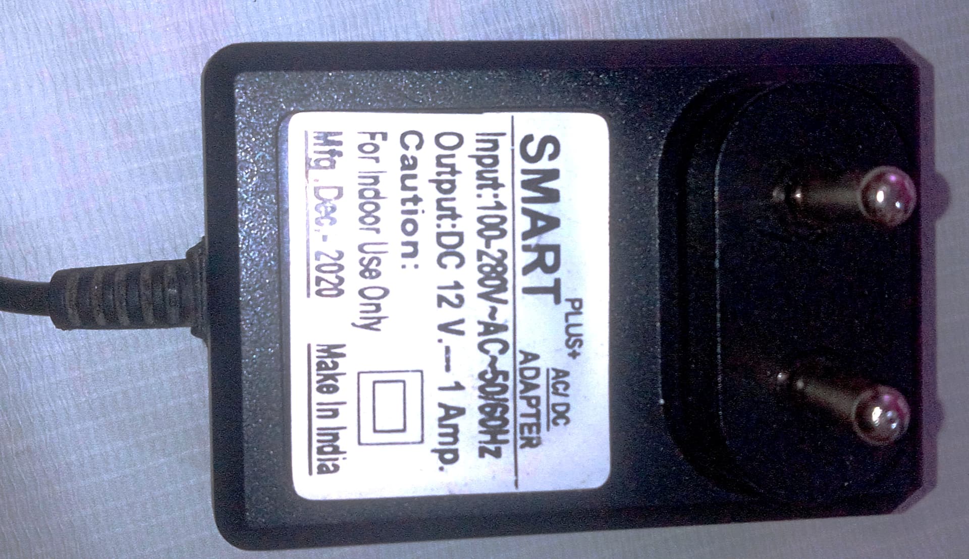

GSM External Power Supply
(Smart Plus AC/DC Setup-Box Adapter)
Input : 100-280V ~ AC ~ 50/60 Hz
Output: DC 12V - 1Amp
Max current: 2Amp.

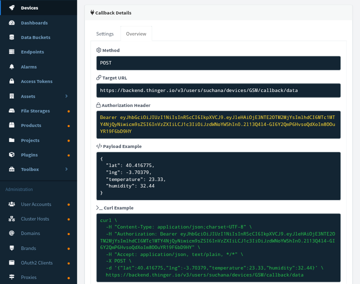

Thinger.io Databucket Setup
I've setup Thinger.io Databucket to recieve data. This requires cURL request
curl \
  -H "Content-Type: application/json;charset=UTF-8" \
  -H "Authorization: Bearer eyJhbGciOiJIUzI1NiIsInR5cCI6IkpXVCJ9.eyJleHAiOjE3NTE2OTM2MjYsImlhdCI6MTc1MTY4NjQyNiwicm9sZSI6InVzZXIiLCJ1c3IiOiJzdWNoYW5hIn0.2l13Q4l4-GI6Y2QmP6HvsoQdXoIm8OOuYR19F6bD9HY" \
  -H "Accept: application/json, text/plain, */*" \
  -X POST \
  -d '{"lat":40.416775,"lng":-3.70379,"temperature":23.33,"humidity":32.44}' \
  https://backend.thinger.io/v3/users/suchana/devices/GSM/callback/data
cURL POST request sent - Unauthorised Access Error

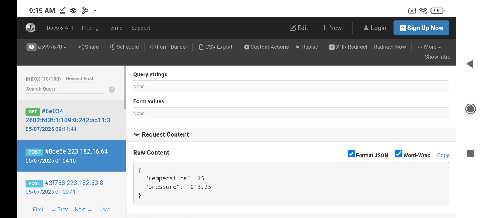

This indicates that required Authorization header missing. To confirm this, I've replaced Thinger.io API endpoint with webhook.site. My temporary URL generated is http://webhook.site/a5997670-50f5-436d-9011-22fe30313400.
Webhook Confirmed same that Authorization header missing
Webhook detected a POST request that is comming from GSM module. On inspection it is confirmed that Authorization header really missing. Here's what I recieved.
Headers
Raw Content
{"temperature":25.0,"pressure":1013.25}

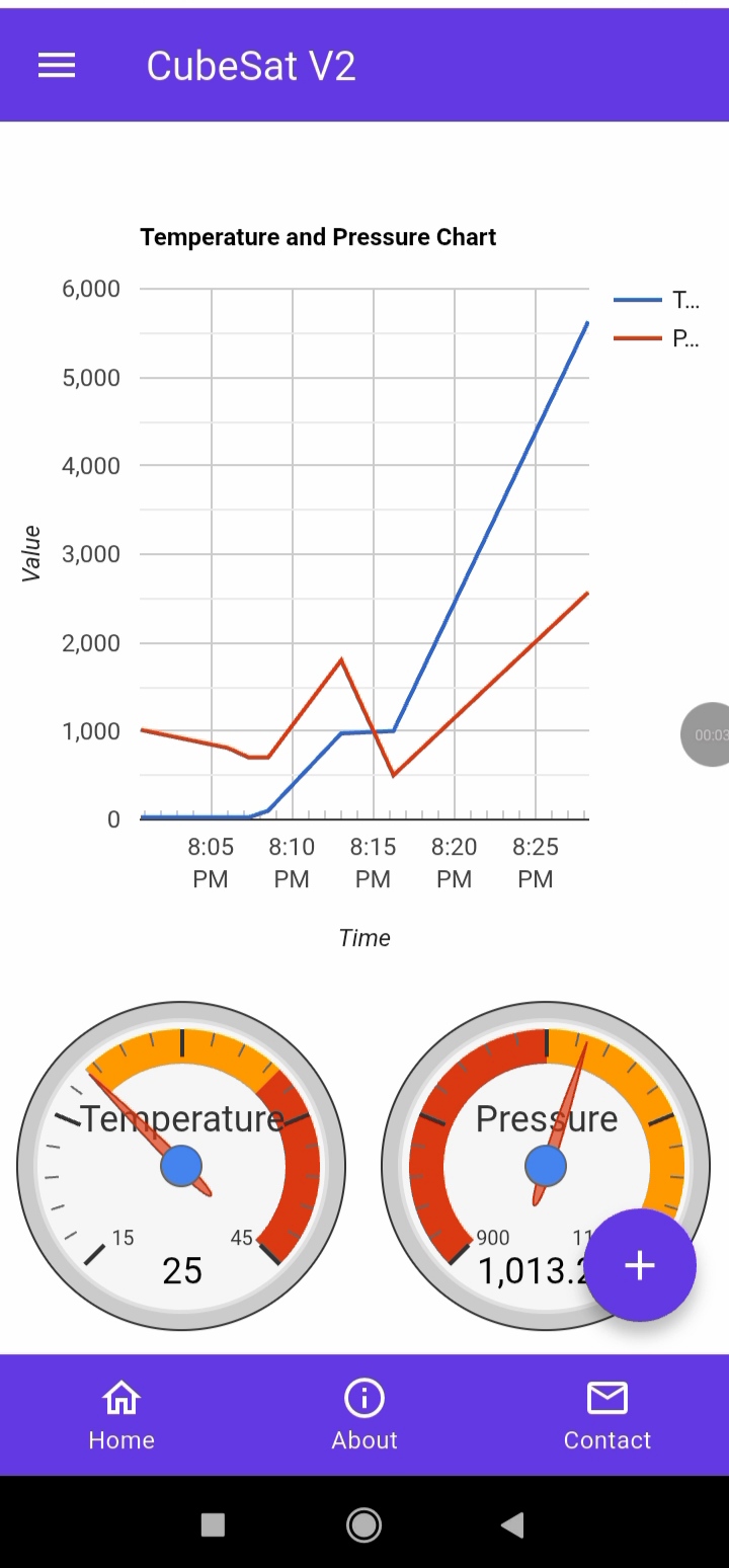

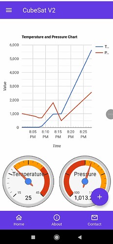

This JSON can be parsed and display using interactive Google Charts as depicted below.
But NOTE:
This get updated only when our earlier cURL request with Authorization Bearer header succesful.
Display using Interactive Google Charts
Once if Authorization header sent successfully and data get stored in Thinger.io, will modify the code to send actual BMP280 data every min and display it over a web application using Google Charts. Here's the video: https://drive.google.com/file/d/1EVt3PvdPBg0xklS0fkXEmxrlLFrhfu1w/view?usp=sharing
Conclusion:
No issues in recieving data from Thinger.io and displaying as Google Chart. Issue at sending data from GSM. POST request successful. Raw data being sent. But closure investigation revealed that Authorization Bearer header missing. This needs to be resolved.
