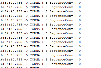

[Solved] Using DMA/Fast Communication on portentaH7
Has anyone had fun with the DMA function on PortentaH7. I am using a code where my ADC is converting based on a timer TRGO and the data is supposed to be sent to the buffer I defined in memory yet I do not read the data at the specified address even though the interrupt for the DMA transfer complete is triggered. Here is my code :

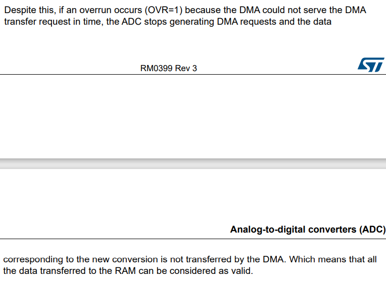

Note : The ADC setup allows for conversion at a maximum rate of 900kHz all you need to change is the ARR and PSC register of TIM1 (and switch data management to the ADC Data Register) to check that the problem does not come from the ADC . To go any further than 900 kHz change the system clock and the ADC DELAY, SMP, RES (for it to end conversions before another TRGO2 is generated by the TIM1).
Update : I managed to have the DMA work this way :
-I declared a new structure within the shared memory of my two cores (SRAM3 in my case according to datasheet advices, look for AN5617) :
struct shared_data
  uint8_t sts_transfer;//status : 1=transfer complete 0=waiting
  uint8_t sts_buff1_or2; // status : 1=M7toM4_1, 0=M7toM4_2

  SET_BIT(ADC2->CFGR, ADC_CFGR_DMNGT_0 | ADC_CFGR_DMNGT_1);//DMA Circular mode
  /********************OVRMODE*****************************/
  SET_BIT(ADC2->CFGR, ADC_CFGR_OVRMOD_Msk); //Erase old data
  /********************CONT/Single/Discont*****************/
  SET_BIT(ADC2->CFGR, ADC_CFGR_CONT_Msk); // | ADC_CFGR_DISCEN_Msk continuos mode

Works fine :
Here code modified :
/*************Function prototype************/
void ADC_Init();
void DMA_Config();
void VREFBUF_Init();
/*************BUFFER***********************/
struct shared_data
  uint16_t BufferADC1[10];
volatile struct shared_data * const xfr_ptr = (struct shared_data *)0x38001000;
//uint16_t *temp_address = BufferADC1;
volatile uint32_t TComplete=0;
volatile uint32_t Eosmp=0;
volatile uint32_t Eocie=0;
  delay(100);
  DMA_Config();
  VREFBUF_Init();
  ADC_Init();
  AC_TIMER1_Init();
  SET_BIT(RCC->AHB1ENR, RCC_AHB1ENR_DMA1EN_Msk);
  SET_BIT(ADC2->CR, ADC_CR_ADSTART_Msk); //Start ADC
        Serial.print("TCDMA : ");
        Serial.print(TComplete);
        Serial.print(" SequenceConv : ");
        Serial.println(Eocie);

Thanks for the quick reply and the tip :slight_smile: . I think I didn't frame my question properly. The DMA works fine but the values are not updated for every iteration.
BufferADC value: 283
BufferADC value: 149
BufferADC value: 144
BufferADC value: 151
BufferADC value: 157
BufferADC value: 155
BufferADC value: 156
ADC->DR value:144
ADC->DR value:4095

An hypothesis :
To verify it add the Overrun interrupt on the ADC and add a counter if it goes above zero that might explain the transfer failure, I already added that part in my previous code, I repost it here :
void ADC_IRQHandler(void) {
  if (ADC2->ISR & 0x10) {
    Ovrun += 1;
    SET_BIT(ADC2->ISR, ADC_IER_OVRIE_Msk);
In the ADC part don't forget to enable the interrupt associated. You can also check the transfer error directly with DMA interrupts.
