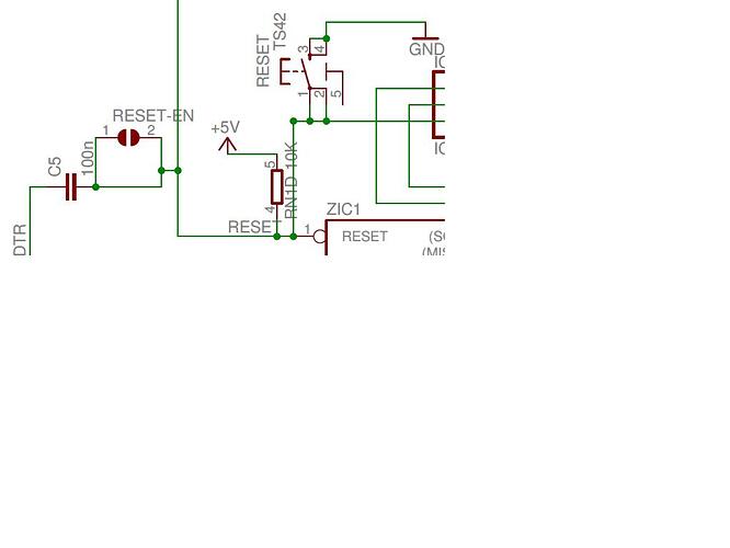

Auto-reset works by connecting the DTR line to RESET through a capacitor and pulling it low thereby temporarily lowering RESET too.
The value of the 10K pull-up and the 0.1uF cap are designed to create a reset pulse with the appropriate high-low-high transition. Too much capacitance will cause the reset waveform to be malformed and too little capacitance will cause the reset waveform to be too narrow and potentially not go to signal ground.
You can find out more here: More
Ray

Follow DTR on the left side of the schematic...
