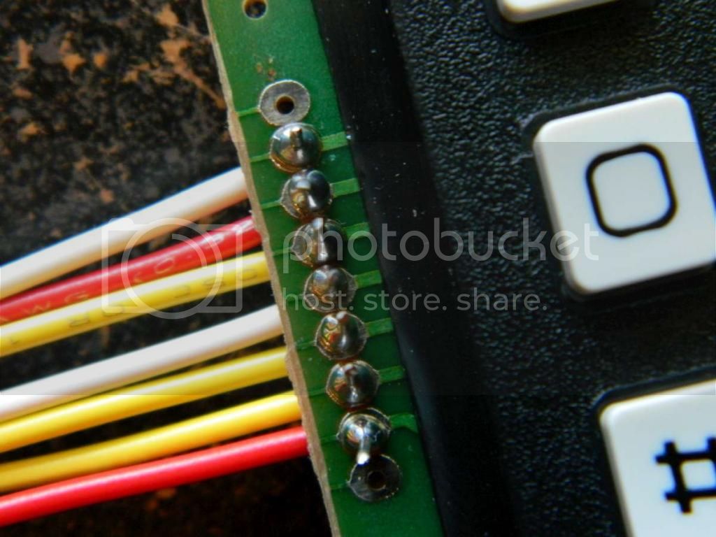

Those solder joints looks very suspicious!
Is the solder even contacting the pads below ? It almost looks like there is no pad underneath the solder, almost like someone ripped it clean off...
Please take a better picture from a different angle of this

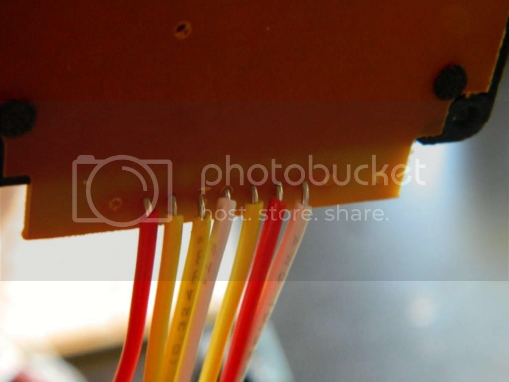

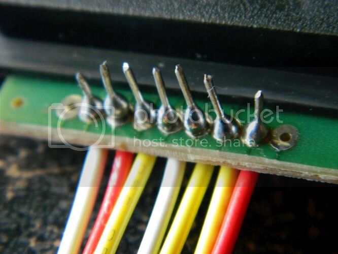

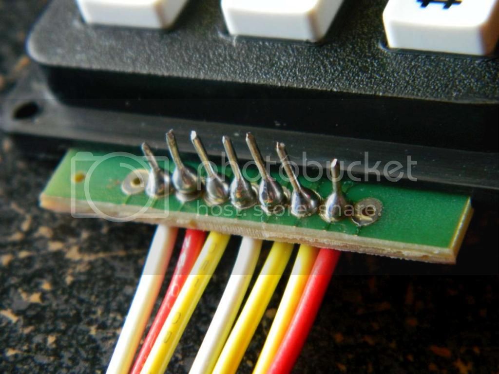

I tried to be very careful when I was soldering, and I tried pulling on the wires connected to the keypad to see if they were lose, but they seemed to be very secure. Here are the pictures you requested.

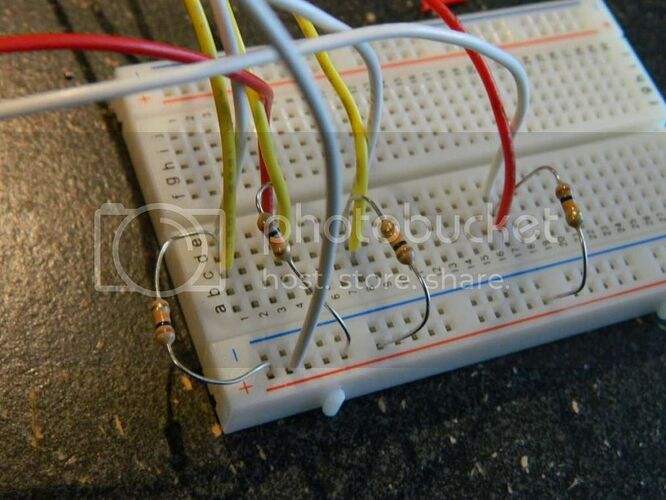

Why are you using pull down resistors? Take them out.

I resoldered all the connections so I'm just about 100% sure it's not my connections that are bad. I touched pins 5 and 8 but nothing happened. The reason I was using the resistors was because I was following this tutorial: http://bildr.org/2011/05/arduino-keypad/
You won't need external resistors or diodes because the library uses the internal pullup resistors and additonally ensures that all unused column pins are high-impedance

I solved my problem, and I think I spotted yours. Your resistors, are they going to GND or V+?
