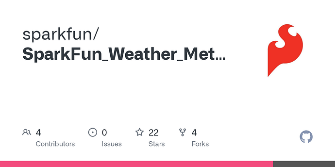

Sparkfun recommends various boards that will work with the weather station kit and their sensor library here:

Thanks for the library man :call_me_hand::call_me_hand:
