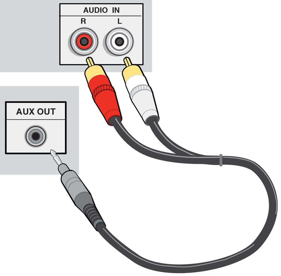

  1. So let's see if I'm making the right assumption. I am going to need a cable similar to the picture that's in the attachment. I need a wire for the MSSGEQ7 left Hand at Pin 5 and another wire for the MSGEQ7 right hand Pin 5. Is this correct? BTW, I'm still trying to figure out my capacitor and resistors values for the equalizer chips. Still doing research.

The MSGEQ7 has an analogue output that must be connected to an analogue input of the Arduino. Each chip to a different analogue input. There are other digital inputs to this chip and these must be connected to the Arduino however these can be common on the two chips.
