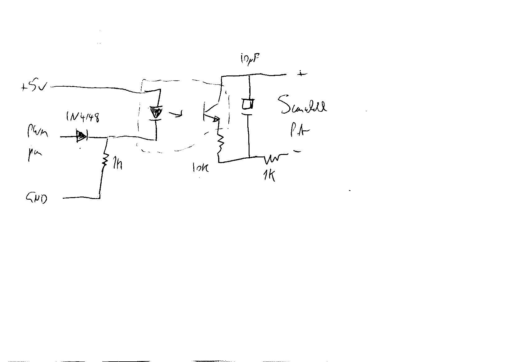

So we're not dissipating a ton of power. If I'm right and it's a voltage sensing issue, is there a way to cleanly provide a voltage drop with the Arduino? A PWM-controlled transistor or some such? Any other ideas?
I'd try an opto isolator and smoothing capacitor driven by a PWM pin. See attached. The reason for the slightly strange way in which the Arduino drives the opto isolator is so that while it is powering up, the opto is turned on, thereby turning the motor off.
Okay, I went the optoisolator-with-two-opamps route. I now have a cute li'l circuit (HCNR201 for the opto, and 2xLM358 for the opamps) which will take 20V from the motor control for the output supply and 5v from the arduino on the input side, and happily amplify an input signal by 4x.
