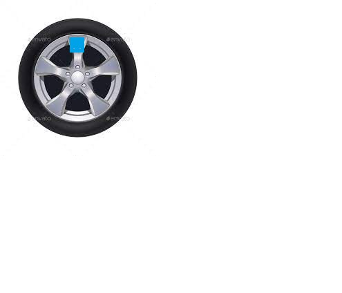

can you post a picture of the rotating part where you want to mount the
microcontroller and the sensor?
the coloured part will be my sensor and i am going to make a cas to hold it in place
i got it to detect speed of a car i will use a speed sensor
Aha. Hm mounting it at this position will dis-balance the wheel.
Usually car-wheels are balanced carefully down to the range of 5 grams on a balancing machine that analyses where to place a 5 gram 10, gram maybee 20 gram weight made out of lead.
Which is then stuck to the inner side of the wheel so that the centrifugal force is helping to keep the weight in place.
With mounting your box on the side the centrifugal forces will be so great that you would have to drill wholes into the rim and tighten your box with screws.
With any glue it will fly away.
But then any insurance will say uncertified modification of the rim we don't pay
You will have a permanent radial load that makes your car vibrating.
You would have to seal it completely to avoid water coming in if the street will be ever wet. This sealing has to be of the highest quality possible.
The signal out of the mpu6050-sensor will be an increasing g-force-signal that will be disturbed by any bumb of the car
So my recommendation is to use something completely different for measuring the rpm.
I feel somehow sorry to say that. But that is the truth that will prevent you from going down longer on this path that is very likely to turn out into not working.
Your title says speedometer that means measuring speed. That is something different than rpm.
What do you really want speed or rpm?
For speed you could use a GPS-module

For measuring rpm: rpm of the motor or rpm of the wheel?

OK. Finally you were able to reveal what your project is. You seem to have not read every line of post #39 ( the long one) I recommend reading it carefully.
After reading it you will have a better base to decide if you want to go on using the mpu6050-sensor on the wheel or something else.
