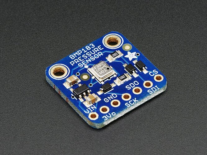

SPI for LCD and Pressure Sensor
I am using an Arduino Uno with a BMP183 barometric pressure/altitude sensor, and a Thermistor.
The output of the devices will be displayed on a 20x4 LCD. The default MOSI, MISO, SCK, and SS pins (11, 12, 13, 10 on the Arduino) are being used by the LCD, and I want to use any remaining pins on the Arduino for the BMP183 using SPI. I am having trouble writing the code correctly. I wanted to use pins 2-5 for the BMP183 using SPI.
Currently the Thermistor integration works fine, but the BMP183 is not showing reading on the LCD. I presume that I don't have the setup correct for the BMP183. Any help or feedback would be greatly appreciated.
This is what I have so far:

Hi mbeard
First, could you edit your post and put [nobbc] [code] [/code] [/nobbc] tags around the program. It makes it much easier to read.
About your problem ...
Do you mean that you are not reading correctly from the sensor, or that you cannot display the values on the LCD?
If it is the second case, have you tested the LCD with an example program?
Regards
Ray
Hackscribble,
Thanks for the reply! The LCD is working, but is not getting a correct signal from the BMP183. I don't think my code is properly setup
If this helps, my LCD setup is as follows:
Here is also some BMP183 info:
Please put code tags around your code in the original post.
The LCD does not get a signal from the sensor. Your program reads the sensor, does some processing and then writes text to the LCD.
It looks like your program has Serial.print statements in it. Have you checked that your calculations are giving the right results (which means the problem is in writing those results to the LCD)?
The LCD is working
So, just to be clear, you have run another program that writes to the LCD and it displays correctly?

My code has serial prints in it so I can track readings in the compiler window. I think my calculations are correct.
When I try to use this BMP183 test code, the serial window says there is a wiring problem, which leads me to think that my pin assignments/SPI setup are incorrect.

In your main program, you used pin 5 as software SPI CLK pin for the sensor.
In the test program, you use pin 13, which will clash with the hardware SPI for the LCD.
The MISO and MOSI pins are also different between the test program and the main program.
