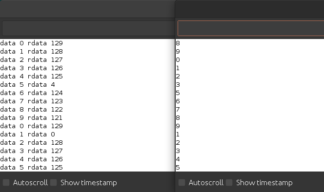

Below output shows the o/p of the master on the left and slave one the right:
The master prints the data it has sent(to the slave, "data" variable) followed by the data it has received (from the slave, "rdata" variable). The slave simply prints the received data (from the master).
If you look carefully at the pic you would see that the master sometimes gets the same data (in the next cycle) it has sent (in the current cycle) (0 and 4 in the pic). At the same time, the slave fails to receive exactly that data (0,4). Also, you can the value of 'indx' is not decremented and the master receives the decremented value in the next cycle. These two things prove that the Slave ISR is not being called randomly (hence the data in the SPDR is not read which is then echoed back to the master plus the index variable is not decremented). Is there a solution to this? I would be really grateful if someone could help me with this.
Also, I face the exact same problem with the current SPI library too.
The only way I see this to happen (after reading through the complete section in the datasheet) is that the SS pin goes HIGH too fast. On the slave side the SPI hardware is reset and a pending interrupt might be cleared.
Can you try to wait a microsecond before pulling SS HIGH again on the master?
@pylon
Thanks a lot for your suggestion. I am really sorry for replying so late. For some reason, the problem stopped occurring by itself. Not sure if it was a wiring issue (loose contact/ capacitance due to long wires). But still as you have mentioned I am keeping a delay to be on the safer side.
