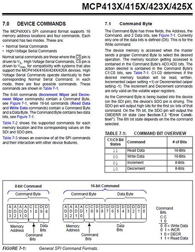

According to the data sheet (couple snapshots of it attached, over 1MB so couldn't attach the whole thing), it says the SPI string should be 16 bits, with the first 6 identifying which potentiometer to control and the next 10 for the "data".
In the below code you can see I'm currently trying to send 16 bits, but I was previously sending decimal 17 or 18 based on the below link...that would sort of let me control 1 of the pots, but not consistently.

  1. You are not driving the chip select pin - you have to do this for every transaction in SPI.
  2. SPI library moves just 1 octet per call to transfer
  3. You don't understand binary constants. 0b0000000001000000 is binary,
    0000000001000000 is octal (and overflows 16 bit integer value anyway
Perhaps something more like this is needed (read the datasheet for definitive
information):
  digitalWrite(tempCSPin, LOW);
  SPI.transfer (0b00000000) ;
  SPI.transfer (0b01000000) ;
  digitalWrite(tempCSPin, HIGH);

It does indeed claim in the datasheet to have 257 different position settings.
Although at Table 5-1 on page 37, they seem a bit confused. In the table, it shows that 0 = 0x00, 1 = 0x01, and so on, to 255 = 0xFE, 256 = 0xFF, and 257 = 0x100, which is wrong and silly. I noticed this made no sense years ago.
Reading further along in the datasheet, it seems the device uses 9 bits of memory to store its position setting, and numbers up to 0x101 are valid, with 0x100 and 0x101 both representing the maximum setting, with different other behavior.
Furthermore, the data you send to the device to set its position needs to be 10 bits, of which it uses the least significant 9 bits.
The SPI command message to this device is supposedly 16 bits, where the 10 bit data component consists of 2 bits on the first byte and 8 bits in the second byte ( of which it then uses 9 bits ).
Apart from the mistake in their drawing, it appears that this device does actually have 257 output settings.
If you are using the version of the device with two potentiometers on the same chip, the instructions for controlling one, or the other, are pretty clear in the datasheet. I assume that you have read more than one page of it.

SPI.transfer transfers 8 bits - that's all it does. You can use whatever value you
like, binary, octal, decimal, hexadecimal constant or the value in a variable. SPI.transfer
transfers 8 bits, so if a chip needs 16 bit SPI transaction you call it twice.
"constraint" is not "constant"!
Yes, it was on pin 8, but I have moved it to pin 10 just to keep it standard to what most other use. However, once I got the circuit working, I tried going back to pin 8 just to see if it works and it does. Yes, I have the Uno...I mentioned that above.
Below is my new code, using the "0b" prefix, changing the CS pin to 10 (just to standardize, not necessary) and moving the CS Low/High into the main loop (which after testing I believe is necessary). Everything is working now...appreciate all the help.
