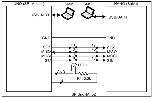

1. Build the following SPI circuit (Fig-1).
Figure-1:
2. Upload the following sketch into SPI-Master-UNO.

4. Press the Reset button of Slave.
5. Bring in the Serial Monitor of Master at 115200 Bd.
6. Check that LED1 is ON and 67 has appeared on the Serial Monitor of Master (Fig-2).
Figure-2:
7. This is the end of of SPIF check.

1. Without having a connection with a SPI slave, you can not expect that the SPIF flag of the Master would be set.
2. The following diagram (Fig-1) says that the arrival of 8-bit from Slave into the SPDR Register of Master will activate the SPIF flag of Master.
Figure-1:
