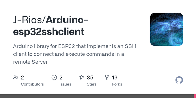

@Juraj: I'm not a native speaker but I understood OP as he wants to SSH from the phone to the Raspberry Pi and not to the ESP8266. BTW your link is for an ESP32 and not an ESP8266.

"I SSH to the RPi from my phone. ... to be able to use the ESP8266 like this"
I know that it is for esp32. It is no so big step to replace esp8266 with ESP32.
