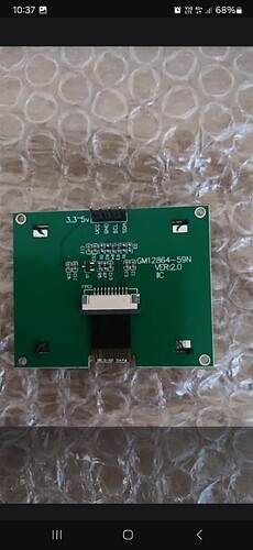

ST7567S I2C 128x64 display can not establish connection with esp32 wroom32. The esp32 doesn't have PSRAM. i used U8G2 library. Full code uploaded to board but i got error message saying PSRAM doesn't found. How can I make it work.

I installed U8G2 library and uploaded the code to esp32 wroom32. I used GPIO21 AND 22 respectively for scl and sda pins
I selected esp32 dev board in arduino ide
I was surprised to see no PSRAM option for the selected board ESP32 Dev Module.
I had ESP32 3.0.5 on this notebook.
Now I updated to ESP32 3.0.7 and all the options are back. PSRAM is disabled initially.

E (140) quad_psram: PS�f5 ID read error: 0xffffffff, PSRAM chip not found or not supported

#include <st7567sfGK.h>
st7567sfGK display;
display.begin(0x3F); // Check the I2C address
display.clear(true);
display.setCursor(0, 0);
display.print("Test!");
// Nothing in loop
which library do you recommend to use
when i upload this code in the serial monitor it says : panic: writecommand error: 4
I am not an anti-aircraft missile; I can't follow a moving target.
thanks a lot, it worked with #include <st7567sfGK.h> library. problem is resolved

Hi Sir, use this code to get it work. #include <Wire.h>, #include <st7567sfGK.h> install these 2 libraries, they are mandatory. Also check wiring. it should work
Here in this code I used GPIO21 as SDA and GPIO22 as SCL. You should follow your microcontroller's manual to find those SDA and SCL pins. Also check if the I2C communication is not conflicting. my display's I2C address is 0x3F. Check your display's I2C address.
