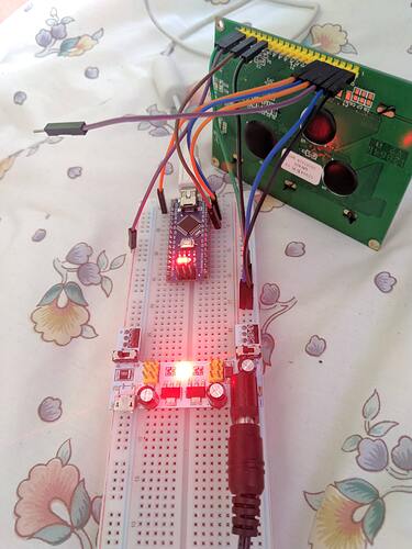

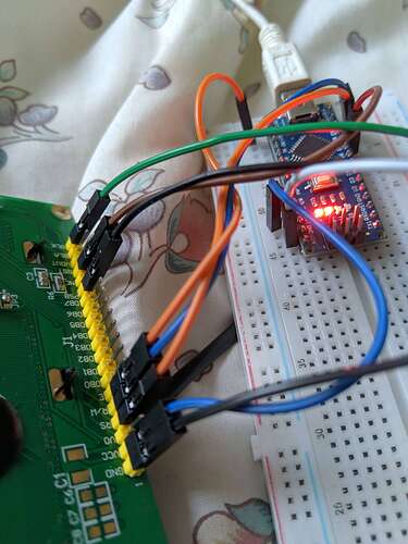

I'm trying to use my ST7920 screen with the u8g2 library, I've tried the old u8glib also. I've first tried to use it in 8-bit parallel mode, but since that didn't work I thought it would be easier to figure out what the problem is with SPI (much less wires to care about). So I hooked up my Arduino Mega first (now I'm trying it with a Nano, thougt maybe my Mega has a problem) as follows:
ST7920 Arduino Nano
GND -> GND
VCC -> 5 V
RS -> 10
R/W -> 11
E -> 13
PSB -> GND (to select SPI)
RST -> 8
BLK -> GND
Here's a photo of my setup:

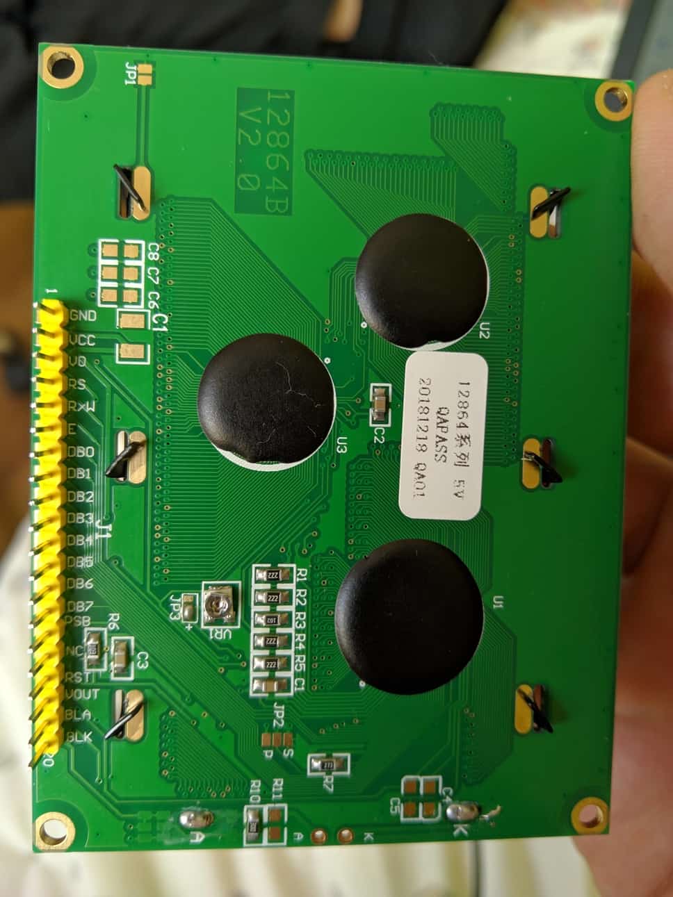

The exact names of the pins can be seen here:
The exact LCD I ordered:

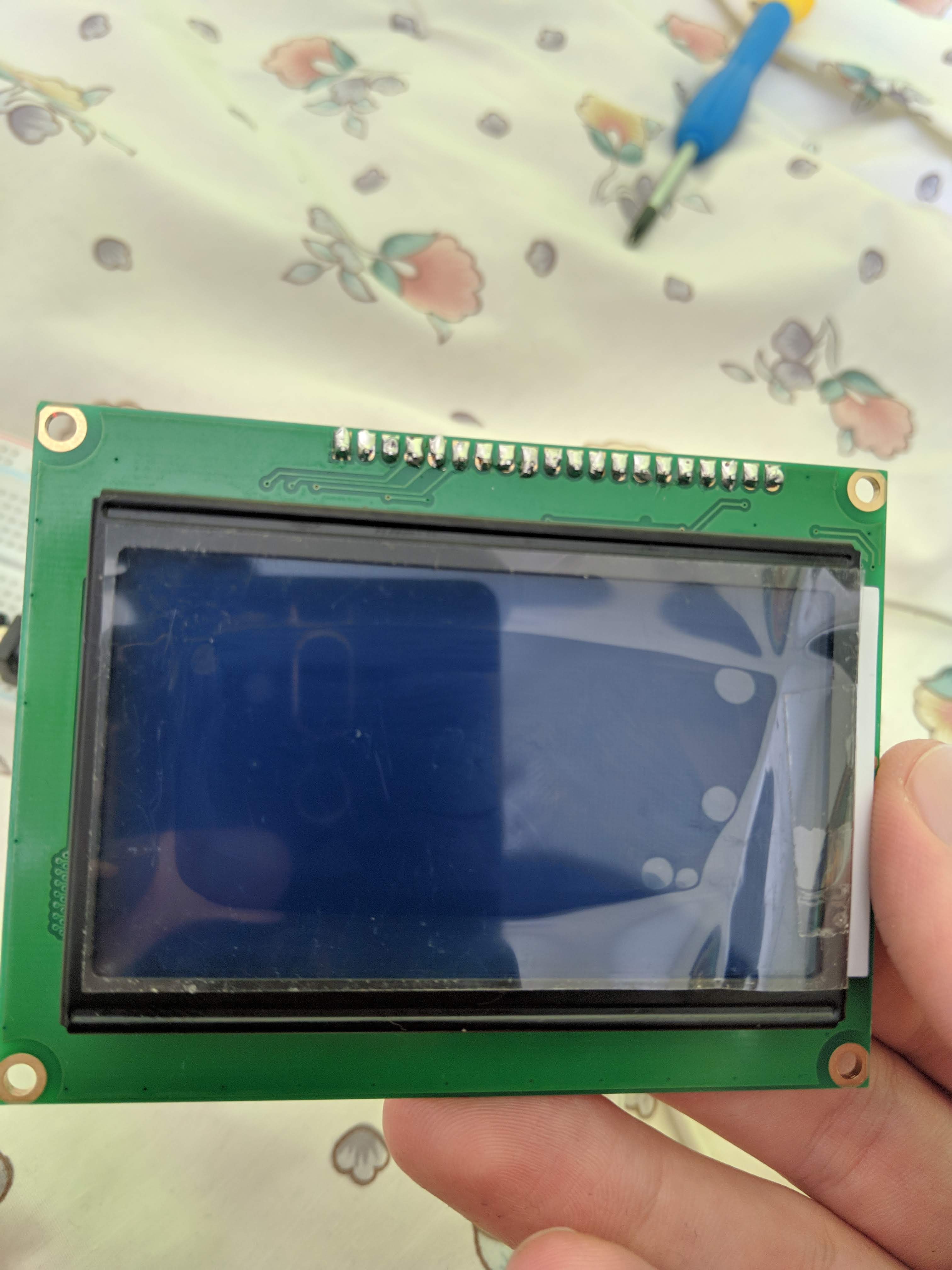

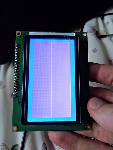

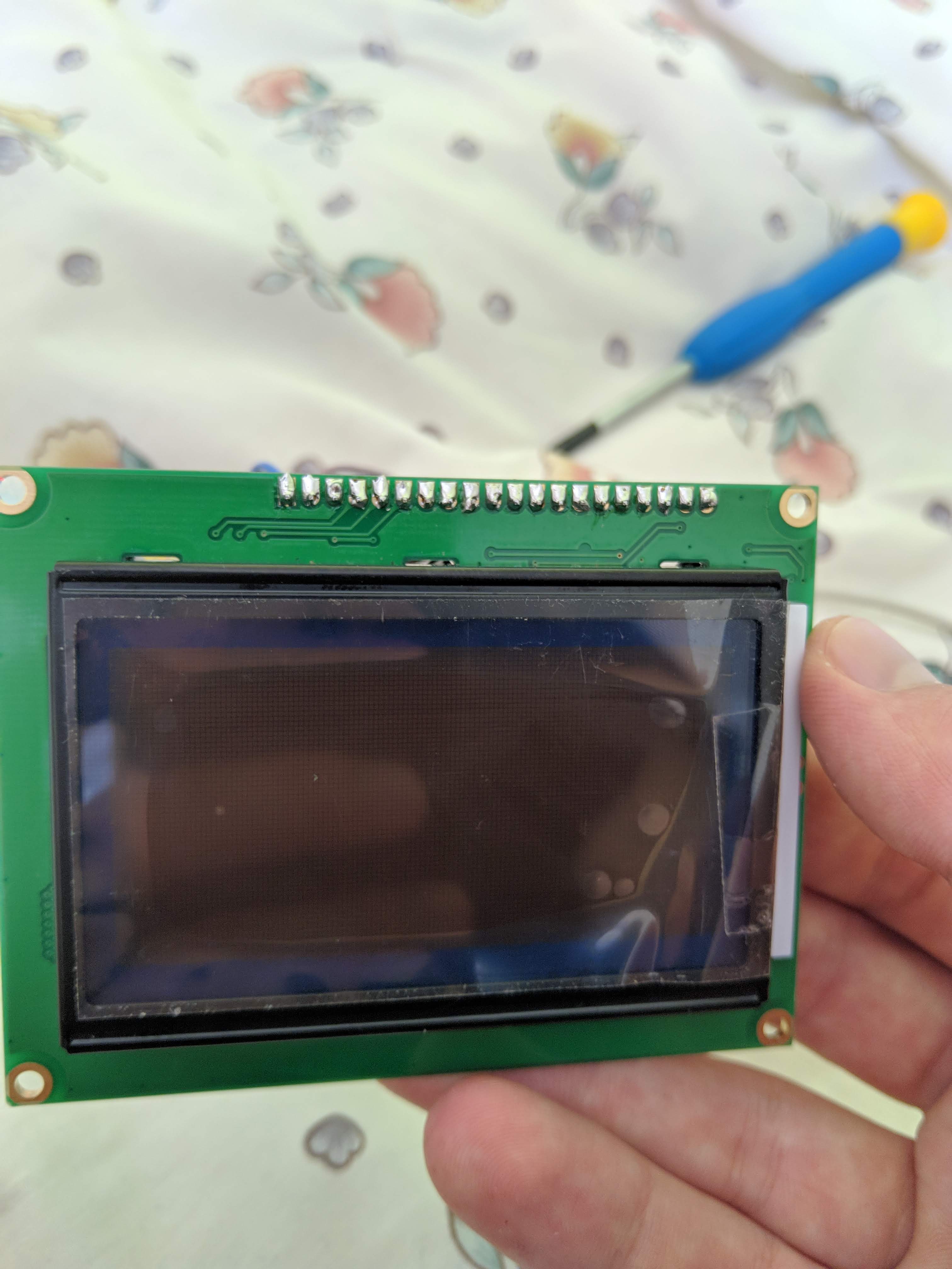

So the problem is I hook up everything, put any example sketch on the Arduino (have tried multiple), but nothing appears on the screen. As you can see on the pin image, there's a built-in potmeter to set the contrast on the screen. When I use that potmeter, the background color of the screen changes, as you can see on the next two images, but nothing else happens.
(and no, it's not because the ambient light is different or because I played with the screen protector).
I also tried to use an external potmeter etc., nothing seems to be working. Has anyone got any ideas I could try?
Go on. It is useful to show a photo of your wiring. But we need to see your constructor. e.g.
U8G2_ST7920_128X64_1_SW_SPI u8g2(U8G2_R0, /* clock=*/ 13, /* data=*/ 11, /* CS=*/ 10, /* reset=*/ 8);
David.

I suggest that you test your jumper wires. (Mind you, your wires look better quality than the typical Chinese male-male jumpers)
Your header strip soldering could be "improved". But it does not look too bad.
Oops. You seem to have separate Nano USB and external power.
God gave you the Nano with a USB cable. It can provide 5V power to the LCD.
Only use the external power if you want to remove the USB cable. i.e. do not use both at once.
If the backlight is too bright, use a 22R, 47R series resistor in the backlight.
David.

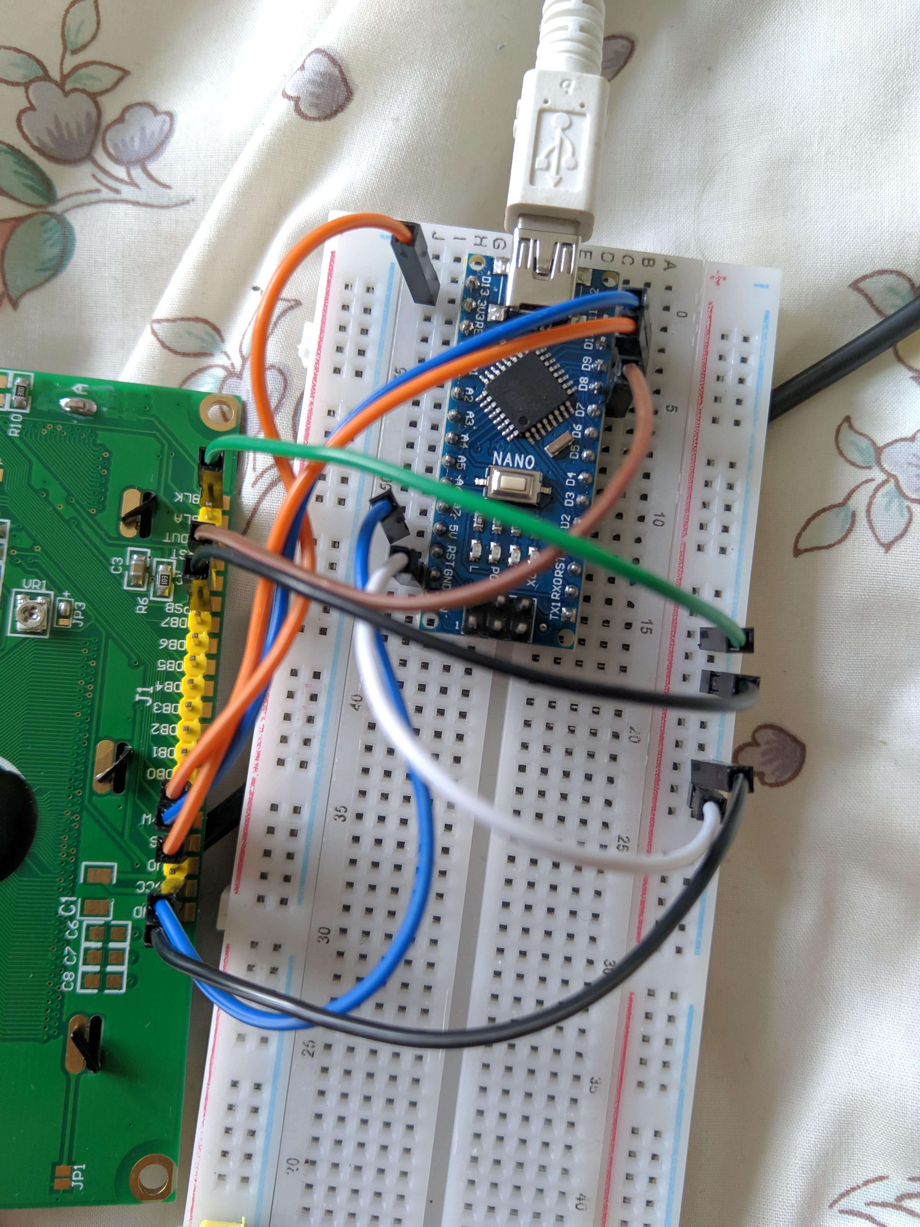

Just double-check your wires. There are not many. Post a photo that shows each colour jumper wire with its associated Nano pin and breadboard row.
Another pair of eyes might spot something.
David.
The current seems okay with the Nano, nothing gets hot and the Power LED isn't dim. So here's my wiring:
BLA is not connected. You always need a backlight on a Blue/White display.
Otherwise your wiring appears to be ok.
David.
Oh, right, sorry. Now I see the backlight (photo). Should that line in the middle be there? I have been seeing that the whole day, just without backlight. Unfortunately, nothing else has changed, no text, no graphics.
