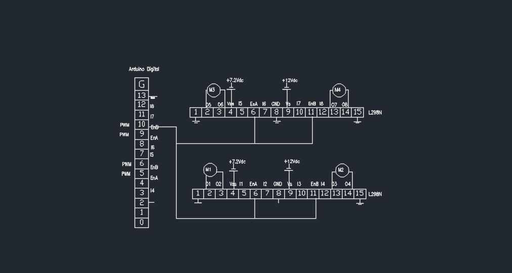

This is wiring drawing
Have to use pin 0,1
don't have extra pin..
Project Wiring.pdf (31.6 KB)
Hi
You can use the Analog pins A0 to A5 as digital?
If you are driving ALL the motors exactly the same directions and speeds, you can halve the Arduino outputs needed by putting the inputs of the driver board in parallel.
Like wire enA and enB together and use PWM6 on one driver and do the same for PWM10 on the other, that way you have saved 2 pins.
Do the same with the I5 and I6.
So you will have saved 4pins in all.
Tom.... :slight_smile:
PS. if you attach as jpg, it will load into the post properly.
Like this way?
Yes and the same for the the IN2, IN4, IN6 and IN8. to a single Arduino output pin.
Tom... :slight_smile:
