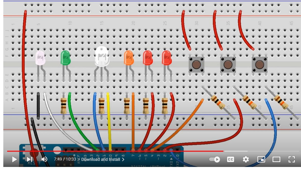

Ok, strode and nav LEDs are working but phasers and photon torpedoes do not. I have checked all of my connections and everything looks right. I using red LEDs for phasers tied to ground using a 100 OHM resistor and the other pin is tied to pin 7. The photon torpedoes are white LEDs and tied to ground using another 100 OHM resistor and the other pin is tied to pins 5 & 6. The phaser button is on pin 4 and photon torpedoes are on pin 2.
Excuse me, the strobe LEDs are tied directly to ground with no resistor.

Ok, the push buttons are connected per your sketch. The pushbutton with the blue jumper wire is tied to pin 8 and all have 10K resistors. The large white LED is the warp/impulse engine LED with the yellow jumper tied to pin 11 and blue tied to pin 10. The yellow jumper is actually tied to a red LED and blue to a blue LED. The orange LED is the phasers and the red LEDs are photon torpedoes but all wired correctly.

Ok, so I recopied the sketch as a new sketch. everything except the torpedo on pin 5 is now working.
So I tried switching pins 5 & 6 around and all that did was swap the reacting torpedoes--in short , before switching pins around the left fired and right did not- after, the right fired and left did not.
Ok, yes that is what happened. But in the original sketch pin 5 fired and then pin 6 without having to hold the button down. It was automatic once you pushed the button.
