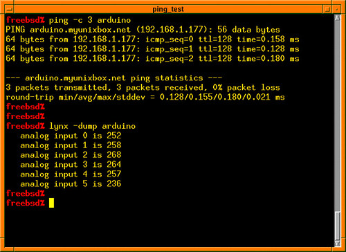

start of an IP-connected audio preamp
so far, just photos of the wiznet module on my arduino, but that's at least a first start - proving to myself that a tiny webserver can really run on this system :wink:
I'm in the process of putting together a digital volume control and input selector for my DIY stereo system and if I can integrate an IP stack in there, too, sure, why not (lol).
I also want to investigate snmp/udp to see if that's do-able, in some way or another.
