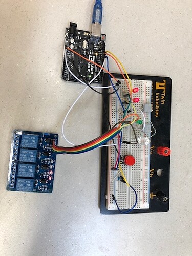

Hi All,
My project is being triggered by static electricity.
While the UNO R3 board is energized running my sketch it will be triggered if I go near it, especially if I remove my jacket with fleece lining near it, 1' to 2' away. No kidding!
I provided a pic of setup and the sketch.
1)I tried coupling cap/resister connecting reset pin to ground on UNO.
2) Tried cap/resistor on buttonpin to ground on ONO.
Any thoughts?

Increase the relative humidity of the room. A well grounded Faraday Cage.
You have an external pullup resistor here :
pinMode(buttonPin, INPUT);
The internal pull up resistors are high value and cause grief - use anexternal 10k resistor instead as a pull up .
If input leads are long look at using optio isolators in your inputs ( and outputs ) .
Put the Arduino in a metal box too - or mount it on stand off on a metal plate connected to 0v.
It’s worth googling “ industrino” to see circuit ideas for ruggedised I/O
Internal pull ups cause grieve? No no no :smiley: Not unless you connect 1m+ of cable and/or place it next to heavy motors or relays. The +-30k of the internal pull up is just fine in 95% of the cases. But floating inputs ARE causing grieve :smiley:

I am not following most of your though. Please be specific i am new and know very little.
So how can i fix this?
If the triggering is coming from an input, try a N.C. switch connected to GND, look for a HIGH on push.
In you code you have:
  pinMode(buttonPin, INPUT_PULLUP);
  // initialize the pushbutton pin as an input:
The last pin mode you set to buttonPin is INPUT, not INPUT_PULLUP which means that input is floating :slight_smile:
:slight_smile: Septillion,
You ar da man...I think this worked, and I see why now. If i set it as just INPUT it is floating between a low and high state, and when I get near it with a static field it can change the voltage on the input pin causing it to trigger.
Big thanks to all you guys!!!

Also looks like you have a resistor in series with the ground pin of the switch. If this was an attempt at an external pulldown, it's on the wrong side of the switch. It should have been placed on the pin side, and not in series, but parallel.
