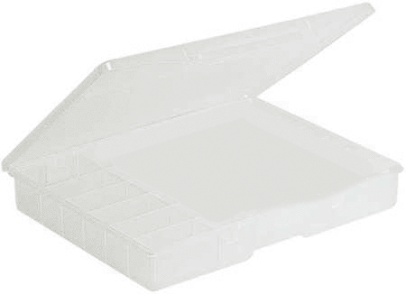

Hi Ardune - welcome to the Arduino forum!
I like compartment cases with most of the compartment dividers removed, so there is a large open compartment taking up 80-90% of the area in the case. Work in the big area, and keep parts & tools in the smaller compartments. It's plastic, but since you said you would be using solderless breadboards, you won't need to worry about melting holes in it.
The best thing about the case is, that when you need to move it, or put it away, you can close up your project in the case without needing to take it apart. Then it's ready to go whenever you have a bit of time.
I have found the most dangerous part of hobby electronics is cutting myself with an Xacto knife. It never fails to stick me. When I cut or drill (or use nippers to cut off bits of wire!) I wear shop safety glasses to protect my eyes from flying bits. Wear closed toe shoes when working with heavy or sharp things. Don't worry about contact with your hands. Even the best fitting, textured nitrile gloves make me lose 50% or more of what little dexterity I had to begin with.
There is no danger with electronics level electricity at all, unless you are using high voltage, high current or 'mains' power for anything. So don't. Until you have much, much more experience, and know the precautions without asking.
One of the first things to buy to go into your case is a wall wart with a USB connector on the end of the wire. Get one that can output 2.0 amps (2000 mA) or more. Get whatever plug adapter you need so you can plug it into your Arduino. Then you will always have a source of clean, safe power for all of your 'internally powered' projects.
Some advanced projects will need 'external power' from a second power supply. If that involves high voltage or current, there will be further safety concerns. But for now, your projects will all run off a single low voltage, low current power supply.
