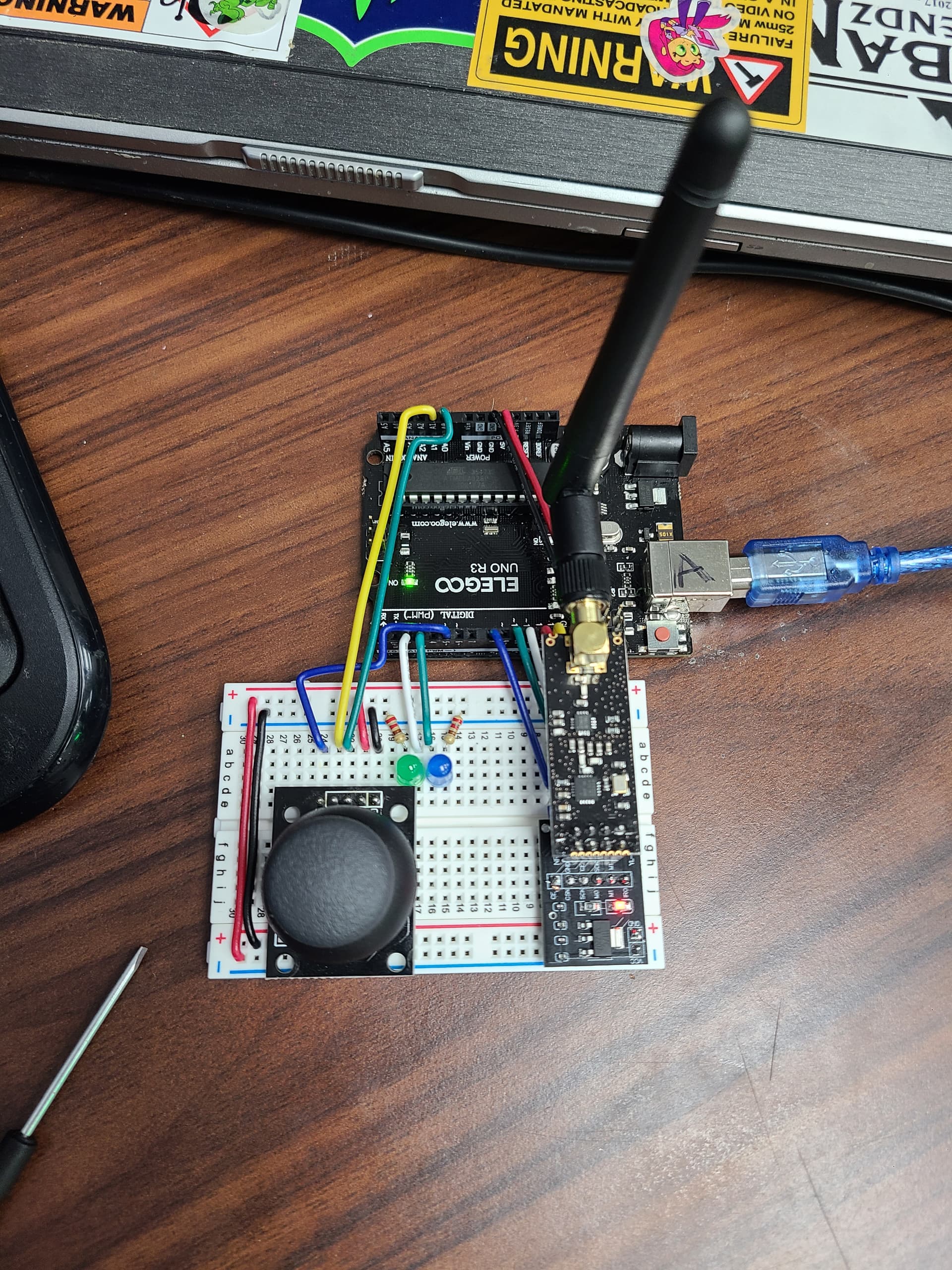

So I checked out that dronebotworkshop sketch for a while and decided to use most of it and that library. I pretty happy with my progress, although there are a few hiccups, but that's to be expected lol.

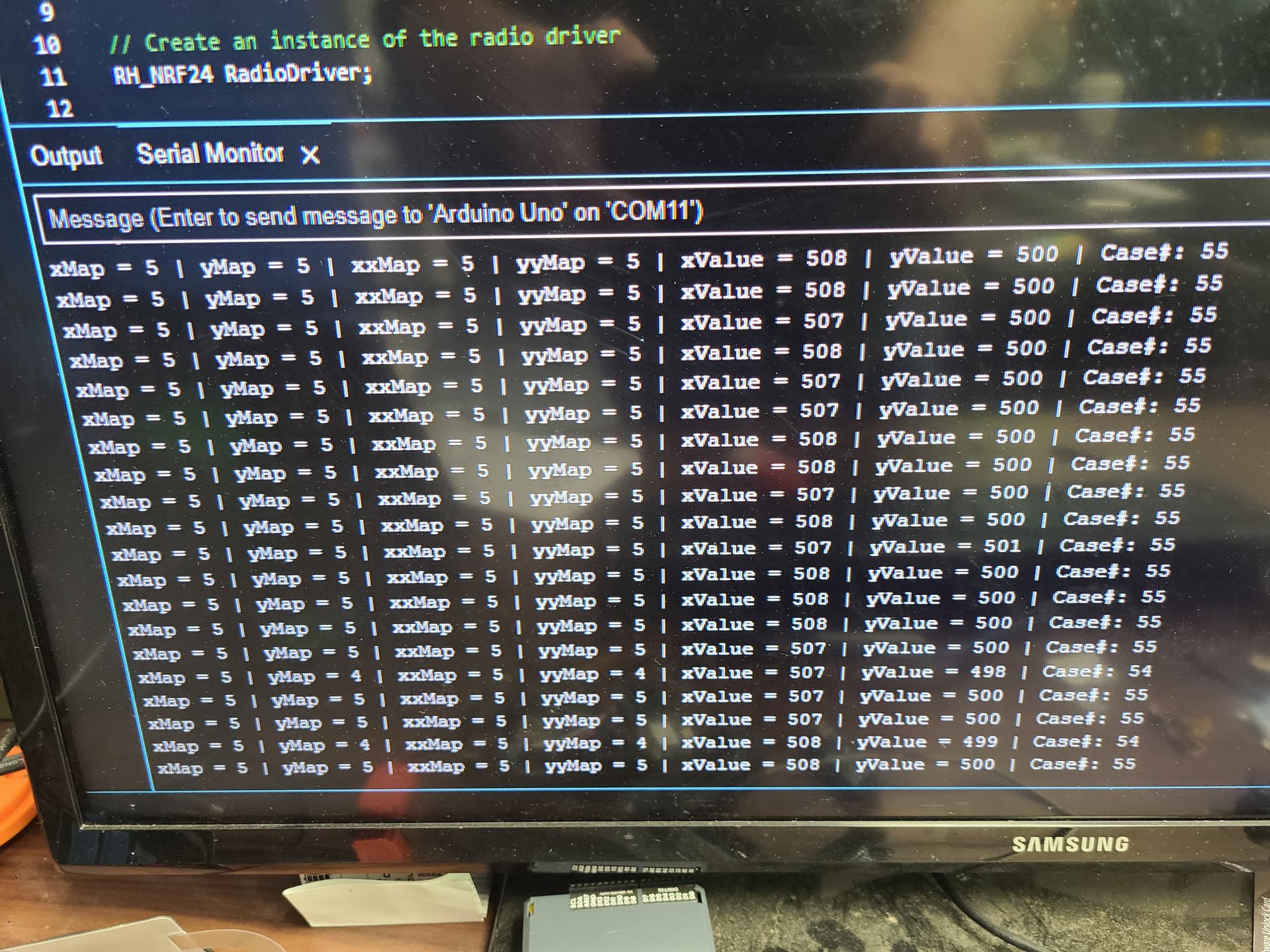

Serial Output:
xMap = 3 | yMap = 7 | xValue = 505 | yValue = 1023 | Case#: 37

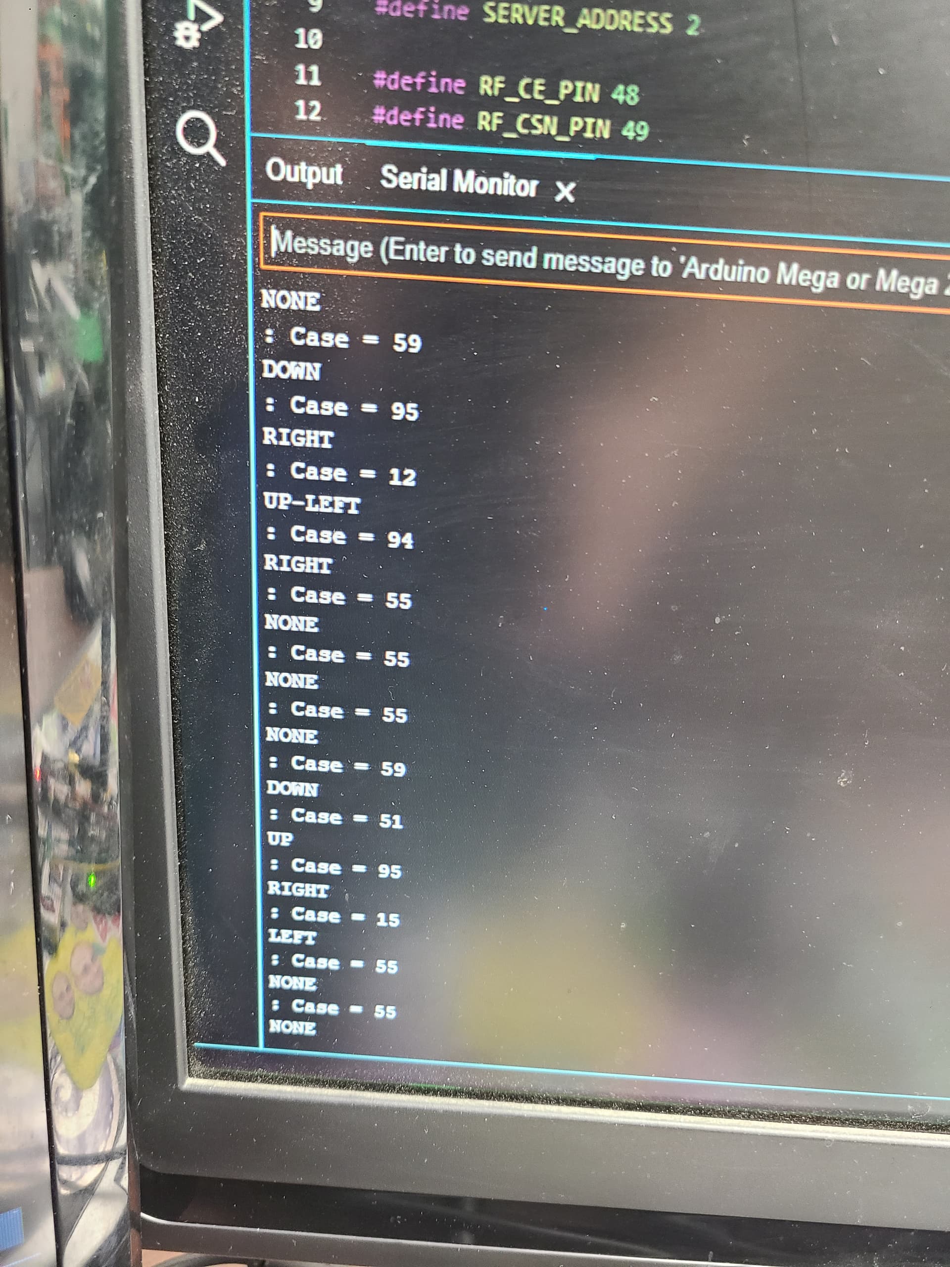

Serial Output:
got request from : 0x1: X = 3 Y = 3sendtoWait failed
NONE

After the receiver successfully receives the data, it's suppose to respond back, but it's not going through. Not really sure why. I'm getting the data correctly, so I might just take that part out, but I feel as though that would be a mistake for future debugging. I also notice that the data rates are staggered. It's not consistent. For example, 3 lines will print to the monitor of the transmitter, then 1 line prints to the receiver, then 1 and 1, then 5 and 3, and so on. Again, not really sure why it does this.
I put the switch statement on the receiver end, that way I can easily use each case to put the corresponding code for said direction, but at the moment it only prints the direction that case is for into the serial monitor.
The printing to the monitor just might be slow so that is to be expected. It is sometimes choppy when there is a lot going on. Good you got a lot done, though. I would just drop the feedback from the rcvr for now and see if the car drives ok.
Okay, fair enough. I'll take your advice and just comment that out for now and work on getting stepper motors to work.
I know that with my current code, driving is gonna be sketchy lol. I think I could fix it a bit by adding more case #'s to each case. For example:

I'm not asking anyone to just fix my code, but does it look alright? I'm sure there is some unneeded lines and some redundancy in there, but overall... is it correct?

Serial Output:
xMap = 3 | yMap = 3 | xValue = 507 | yValue = 500 | Case#: 33

  if (rf_manager.available()) {
    // Wait for a message addressed to us from the client
    uint8_t len = sizeof(buf);
    uint8_t from;
    if (rf_manager.recvfromAck(buf, &len, &from))
    //Serial Print the values of joystick
      Serial.print("got request from : 0x");
      Serial.print(from, HEX);
      Serial.print(": X = ");
      Serial.print(buf[0]);
      Serial.print(" Y = ");
      Serial.print(buf[1]);
      // Send a reply back to the originator client, check for error
      //  if (!rf_manager.sendtoWait(ReturnMessage, sizeof(ReturnMessage), from))
      //    Serial.println("sendtoWait failed");
      // turns the two map variables into a single variable by putting the numbers side by side
      String powersCombinedStr = String(buf[0]) + String(buf[1]);
      int powersCombined = powersCombinedStr.toInt();
      switch (powersCombined) {
        case 30:
          Serial.println("UP");
          moveForward();
        case 33:
          Serial.println("NONE");
          stopMoving();
        case 37:
          Serial.println("DOWN");
          moveBackward();
        case 03:
          Serial.println("LEFT");
          moveSidewaysLeft();
        case 73:
          Serial.println("RIGHT");
          moveSidewaysRight();
        case 00:
          Serial.println("UP-LEFT");
          moveLeftBackward();
        case 70:
          Serial.println("UP-RIGHT");
          moveRightForward();
        case 07:
          Serial.println("DOWN-LEFT");
          moveLeftBackward();
        case 77:
          Serial.println("DOWN-RIGHT");
          moveRightBackward();

Receiver ready!
got request from : 0x1: X = 3 Y = 3NONE
got request from : 0x1: X = 0 Y = 3LEFT
got request from : 0x1: X = 0 Y = 7DOWN-LEFT
got request from : 0x1: X = 6 Y = 0got request from : 0x1: X = 1 Y = 0got request from : 0x1: X = 3 Y = 3NONE
Receiver ready!
got request from : 0x1: X = 3 Y = 4got request from : 0x1: X = 3 Y = 7DOWN
got request from : 0x1: X = 3 Y = 6got request from : 0x1: X = 3 Y = 3NONE
got request from : 0x1: X = 0 Y = 4got request from : 0x1: X = 0 Y = 3LEFT
I would say it more or less functions as it should, however... I'm getting zero response from my steppers/drivers. No lights, no jitter, literally nothing. I'm sort of at a loss. I guess I'll just do some reading about troubleshooting these motors/drivers?

Okay, so I did just that. I grabbed a new Uno, new stepper motor and driver, and uploaded a simple AccelStepper.h example. Stepper worked fine. Great. Then I used that example to cross examine my code for any errors or inconsistencies. I found some and fixed them.
Now the drivers are clearly coming on, but the motors aren't moving at all. Comparing my code with the example, as far as motor control, the only difference if the fact that my control is initiated with switch statements and void functions, and I use a setAcceleration function. So I figured maybe the setspeed and runspeed functions were only being active for a split second, not giving the motors enough time to move, so I tried adding a delay at the end of the void functions and at the end of the switch statements, before the break. Neither made a difference. I also tried removing the setAcceleration function and that too made no difference.
I've also tried unplugging all steppers and drivers except one, no difference.

  xValue = analogRead(xpin);
  yValue = analogRead(ypin);
  // remap the x and y values to be 0-7
  int xMap = (xValue / 100);
  int yMap = (yValue / 100);
  int xxMap = map(xMap, 0, 10, 1, 9);
  int yyMap = map(yMap, 0, 10, 1, 9);
  // concatenate the x and y values into a single variable
  String powersCombinedStr = String(xxMap) + String(yyMap);
  joystick[0] = (powersCombined);
  Serial.print("xMap = ");
  Serial.print(xMap);
  Serial.print(" | yMap = ");
  Serial.print(yMap);
    Serial.print(" | xxMap = ");
  Serial.print(xxMap);
  Serial.print(" | yyMap = ");
  Serial.print(yyMap);
  Serial.print(" | xValue = ");
  Serial.print(xValue);
  Serial.print(" | yValue = ");
  Serial.print(yValue);
  Serial.print(" | Case#: ");
  Serial.println(powersCombined);

Transmitter:
#include <RHReliableDatagram.h>
#include <RH_NRF24.h>
#include <SPI.h>
#include "stdio.h"
// Define addresses for radio channels
#define CLIENT_ADDRESS 1
#define SERVER_ADDRESS 2
// Create an instance of the radio driver
RH_NRF24 RadioDriver;
// Sets the radio driver to NRF24 and the client address to 1
RHReliableDatagram RadioManager(RadioDriver, CLIENT_ADDRESS);
#define xpin A0  // Arduino pin connected to VRX pin
#define ypin A1  // Arduino pin connected to VRY pin
// Define the Message Buffer
uint8_t buf[RH_NRF24_MAX_MESSAGE_LEN];
// Declare unsigned 8-bit joystick array
uint8_t joystick[3];
int xValue = 0;          // To store value of the X axis
int yValue = 0;          // To store value of the Y axis
int previousXValue = 0;  // Set initial previous values to 0
int previousYValue = 0;
  Serial.begin(115200);  // Start serial communication
  // Initialize RadioManager with defaults - 2.402 GHz (channel 2), 2Mbps, 0dBm
  if (!RadioManager.init())
    Serial.println("init failed");
  else Serial.println("Setup complete.");
  // read analog X and Y analog values
  // Divide the values by 100 to drop some zeros, then remap the values to 1-9
  int xMap = map(xValue / 100, 0, 10, 1, 9);
  int yMap = map(yValue / 100, 0, 10, 1, 9);
  // X and Y value buffers
  joystick[0] = (xMap);
  joystick[1] = (yMap);
  Serial.print(" | buffer0: ");
  Serial.print(joystick[0]);
  Serial.print(" | buffer1: ");
  Serial.println(joystick[1]);
  if (xValue != previousXValue || yValue != previousYValue) {  // Check if values have changed
    // Update previous values
    previousXValue = xValue;
    previousYValue = yValue;
    //Send a message containing Joystick data to manager_server
    (RadioManager.sendto(joystick, sizeof(joystick), SERVER_ADDRESS));
Receiver:
#include "RHReliableDatagram.h"
#include "RH_NRF24.h"
#include "SPI.h"
#include "AccelStepper.h"
#include "stdio.h"
#define RF_CE_PIN 48
#define RF_CSN_PIN 49
RH_NRF24 nrf24(RF_CE_PIN, RF_CSN_PIN);
RHReliableDatagram rf_manager(nrf24, 2);
// Define a message to return if values received
uint8_t ReturnMessage[] = "JoyStick Data Received";
// Motor pin definitions:
#define motorPinA1 22  // IN1 on the ULN2003 driver
#define motorPinA2 23  // IN2 on the ULN2003 driver
#define motorPinA3 24  // IN3 on the ULN2003 driver
#define motorPinA4 25  // IN4 on the ULN2003 driver
#define motorPinB1 26  // IN1 on the ULN2003 driver
#define motorPinB2 27  // IN2 on the ULN2003 driver
#define motorPinB3 28  // IN3 on the ULN2003 driver
#define motorPinB4 29  // IN4 on the ULN2003 driver
#define motorPinC1 30  // IN1 on the ULN2003 driver
#define motorPinC2 31  // IN2 on the ULN2003 driver
#define motorPinC3 32  // IN3 on the ULN2003 driver
#define motorPinC4 33  // IN4 on the ULN2003 driver
#define motorPinD1 34  // IN1 on the ULN2003 driver
#define motorPinD2 35  // IN2 on the ULN2003 driver
#define motorPinD3 36  // IN3 on the ULN2003 driver
#define motorPinD4 37  // IN4 on the ULN2003 driver
// Define the AccelStepper interface type; 4 wire motor in half step mode:
#define MotorInterfaceType 8
// Initialize with pin sequence IN1-IN3-IN2-IN4 for using the AccelStepper library with 28BYJ-48 stepper motor:
AccelStepper LeftFrontWheel = AccelStepper(MotorInterfaceType, motorPinA1, motorPinA3, motorPinA2, motorPinA4);
AccelStepper LeftBackWheel = AccelStepper(MotorInterfaceType, motorPinB1, motorPinB3, motorPinB2, motorPinB4);
AccelStepper RightFrontWheel = AccelStepper(MotorInterfaceType, motorPinC1, motorPinC3, motorPinC2, motorPinC4);
AccelStepper RightBackWheel = AccelStepper(MotorInterfaceType, motorPinD1, motorPinD3, motorPinD2, motorPinD4);
int yVal = (5);
int xVal = (5);
  // Setup Serial Monitor
  // Set the maximum steps per second:
  LeftFrontWheel.setMaxSpeed(1000);
  LeftBackWheel.setMaxSpeed(1000);
  RightFrontWheel.setMaxSpeed(1000);
  RightBackWheel.setMaxSpeed(1000);
  // Set the maximum acceleration in steps per second^2:
  LeftFrontWheel.setAcceleration(200);
  LeftBackWheel.setAcceleration(200);
  RightFrontWheel.setAcceleration(200);
  RightBackWheel.setAcceleration(200);
  if (!nrf24.init()) {
    Serial.println("Failed to initialize NRF24L01");
    while (1)
  if (!nrf24.setChannel(1)) {
    Serial.println("Failed to set channel");
    while (1)
  if (!rf_manager.init()) {
    Serial.println("Failed to initialize RFManager");
    while (1)
  Serial.println("Receiver ready!");
    uint8_t from;
    (rf_manager.recvfromAck(buf, &len, &from));
    // Serial.print("got request from : 0x");
    // Serial.print(from, HEX);
    Serial.print("X = ");
    Serial.print(" | Y = ");
    Serial.println(buf[1]);
    int xVal = buf[0];
    int yVal = buf[1];
