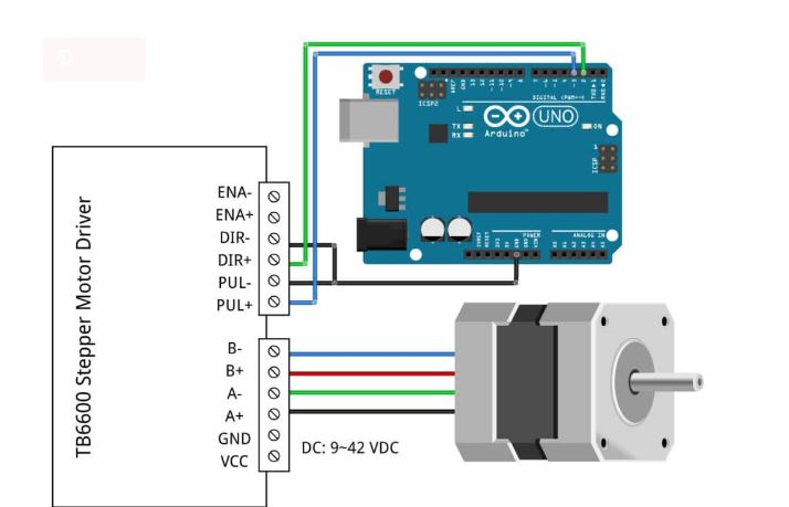

Please post schematics. The HIGH and LOW doesn't make it clear.
What's "pwrOff" connected to? The ENA (enable)?
Yes- pwrOff is connected to enable+ pin. All else is as shown in image minus the hall sensor.
Code has 2 hall sensors for future use, but as long as I can get 1 working smoothly, should be OK.
Thank You!
Why not post a complete schematics? The ENA handling code doesn't look good assuming ENA- is connected to GND like PUL- and DIR-.
Seems like the Hall sensor part of the schematic is as important as anything else.

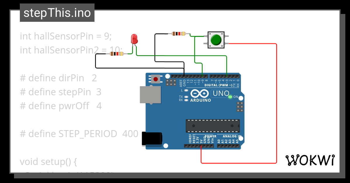

Use a micros () based timer to decide if it is time and appropriate to take a step.
In the same now unfettered loop (), read you sensor and decide if stepping or not.
a7

alto777
February 17, 2022, 3:49am
16
I have no idea if this is the tree y'all are barking up:
Run IoT and embedded projects in your browser: ESP32, Arduino, Pi Pico, and more. No installation required!
but without a life, I had time to play with it a bit.
a7
