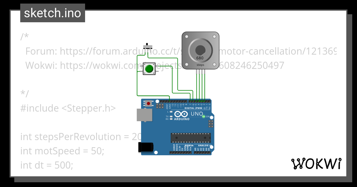

Try this
  Forum: https://forum.arduino.cc/t/stepper-motor-cancellation/1213693
  Wokwi: https://wokwi.com/projects/387900608246250497

Wokwi:
Your idea is a good application for a small state machine ... :wink:
