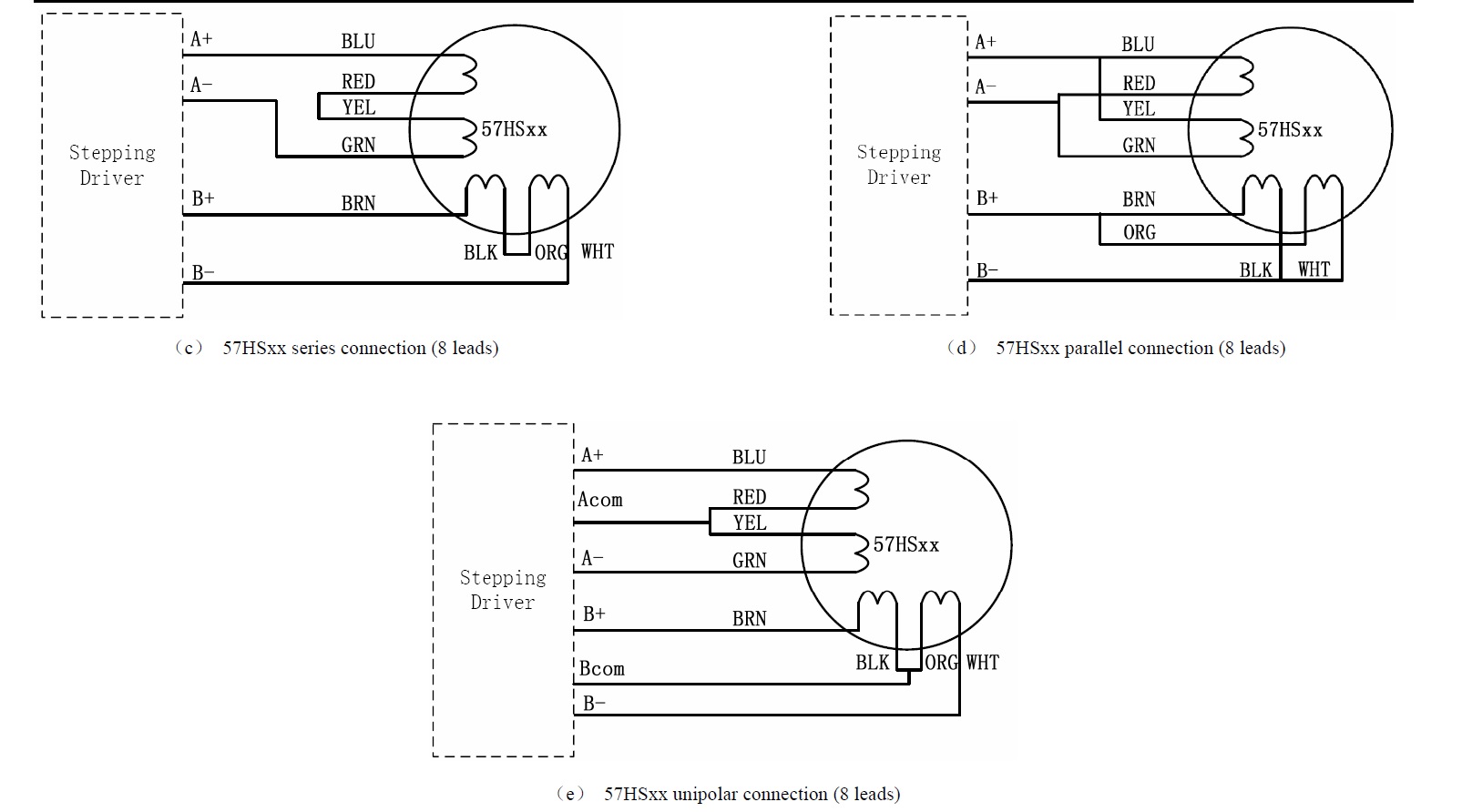

i have leadshine stepper motor driver dm542e "2-phase stepper motor drive to control stepper motor . but i have problem in Dip selection switch. choosing different compination of the Dip leads to hot motor and noise with difficult motion. so i think there is a special configuration. i use power supply 10 A
my stepper motor specs is mentioned in the first post , its model
Stepper Motor (NEMA 23) 57HZ54-09 8 wires
i tried the series and parallel connections. it is connected parallel now
the motor make a sound tic tic and the shaft doesn't move , sometimes it moves and sometimes tic tic. i want to know how to choose the Dip switch

Did you Ohm out the coils to make sure that you know how to wire to the driver?
Post a photo of our wiring. please.
it's hot i can't hold my hand more than 5 seconds. i measured coils ohm it is 2 ohms connected in series
Have a look into your motor data:
Temperature rise: 80°C, rated current, 2 phase on
With an ambient temperature of 20°C you will get 100°C motor temperature. How long will your fingers withstand that? The motor can withstand much higher temperatures than your fingers.
If you don't need the full torque of the motor, it's a good idea to set a smaller motor current to achieve a lower temperature rise.
when i set lower current it makes tic tic without spining, the motor temperature is around 50C
Can you please post a pen(cil) and paper circuit diagram showing your stepper connections (wire colours please) and power supply.
Can you post a link to data/specs of your stepper please?

Did you look at this page of the specs, what configuration do you have?
Tom.. :grinning: :+1: :coffee: :australia:
yes i connected it series ,but the colors are different in my case
Can you please post your code?
You need to do a circuit diagram, not a component image.
