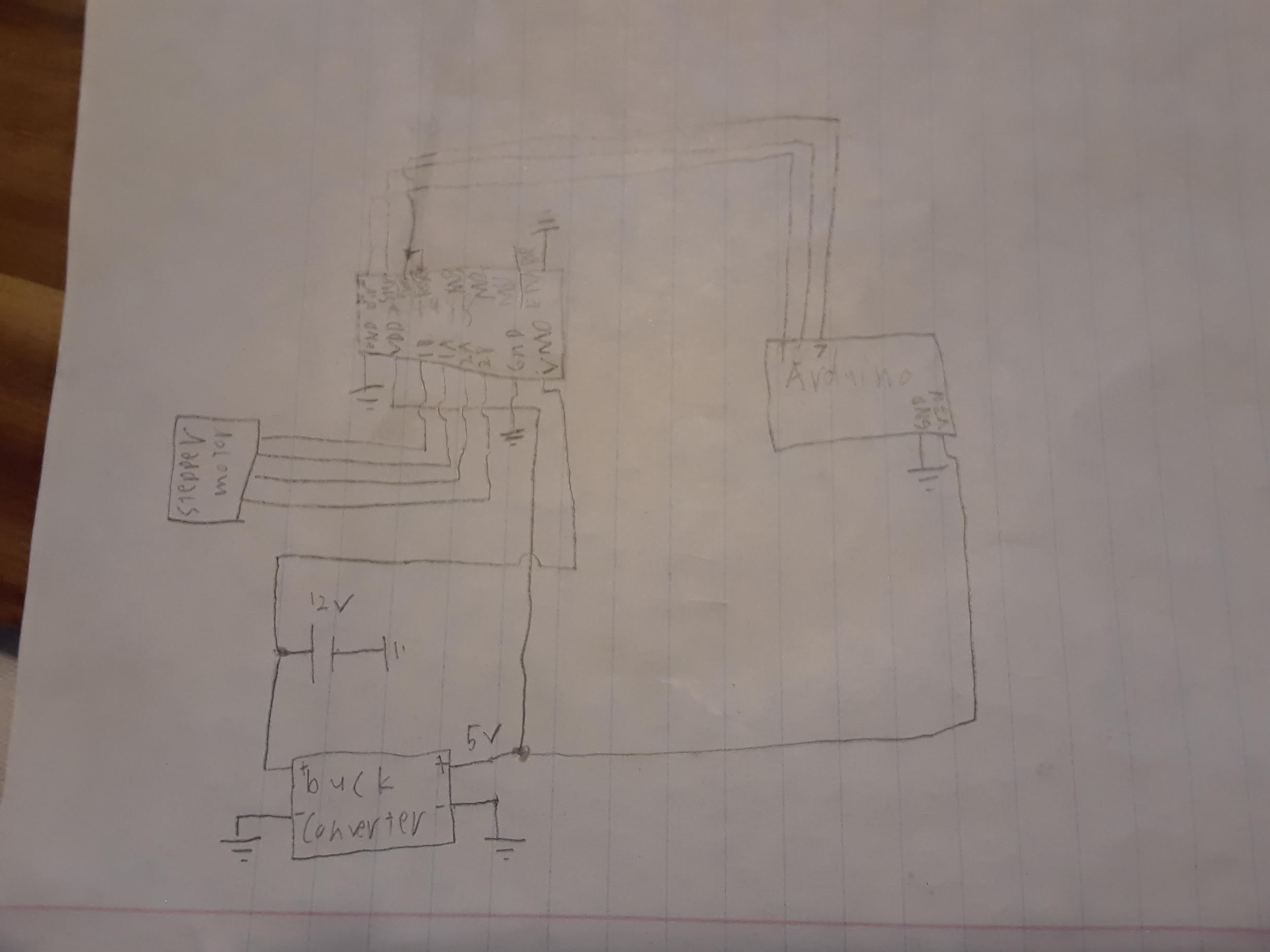

here is a schematic of the breadboard. i'm not sure what the stepper motor driver is but i know it is one that has the step and direction pins.

That sort of diagram is almost impossible to interpret reliably. Just make a simple pencil drawing and post a photo of the drawing.
If you don't know what stepper motor driver you have then post a clear photo of it. If you don't know what it is, then how did you get it?

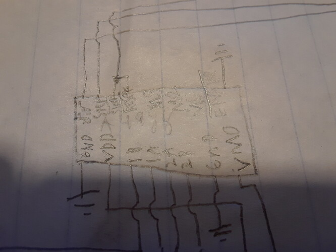

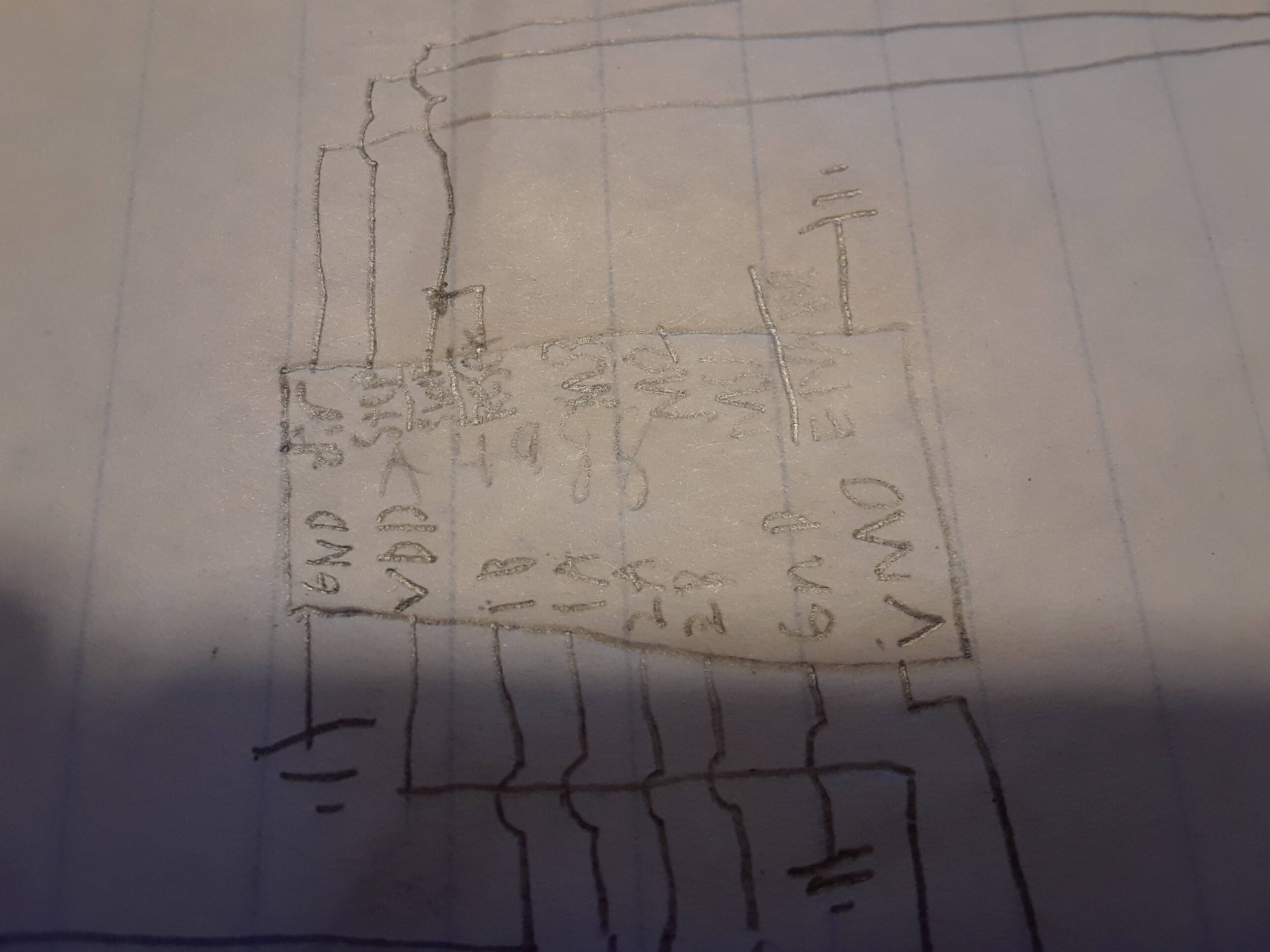

Attached are 2 pictures. The first is a hand drawn image of all motor related circuitry and the second is a close up of the driver chip on the paper.
I have done a bunch of testing with an oscilloscope on both the test circuit and on the original circuit. The only thing I noticed that is different is that the test circuit outputs very clean square waves where as the original circuit has very irregular waves. It almost looks like mains power interference.
Your drawing skills are fine but not so your photography. I can't read your photos.
