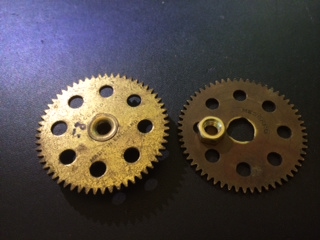

The motor has a 5mm shaft diameter with a flat section , and i was hoping to connect it to a small toothed drive that would drive a larger wheel which drives a M5 brass rod.
I am looking for a end shaft of 1RPM.
I am trying to make a 'Barn Door tracker' controlled by an Arduino board.
See picture below, examples from Meccano.
Any ideas??
Thanks

Perhaps you could bore the Meccano pinion to 5mm to fit on the motor shaft? Then you could use Meccano parts for the rest of the project.

Yes I think I will bore out the Meccano to the required dimension. This requires precision drilling and alignement otherwise it will not work.
I also knocked out the center of the larger gear and now have to find a way to fix / solder a M5 nut in its place. That was when the motor turns, the M5 brass rod will go up and down.

As there is already a centred hole in the pinion drilling it out to a larger size should be fairly simple. Use good quality drill bits and ideally have the drill in a stand to keep it steady and vertical. Another possibility is to hold the pinion in the drill and fix the drill bit in a vice - guarantees concentricity.
I suggest you clamp the nut on the gear with a piece of threaded rod and a second nut. Then you can spin it and check that it's concentric. I would be tempted to fix the nut with epoxy rather than solder unless the loads are very high or the temperatures are high. JB Weld epoxy can withstand higher temperatures and claims to be used to fix engines. A friend glued an injector in a diesel engine with it.

I decided to take your advice.
I opened the centre hole of the smaller gear, and it now fits on the motor.
I am now planning to tap the larger gear with an M5 thread. Bought the thread cutter on ebay, (only few pounds) any will try this.
As a backup I have ordered the epoxy and will use that with M5 nut, and cleared hole.

A couple of things to watch when trying to tap the hole in the large gear ...
You need some arrangement to hold the tap perpendicular. For example if you have a drill stand mount the tap in the drill chuck and put the gear on the base plate of the stand. Turn the chuck by hand only. Another possibility might be to drill a hole in a piece of timber so the tap is a snug fit, but not actually screwing in the wood. Then hold the wood in a vice so that the hole is perpendicular over the gear. YouTube is probably a good place for lessons about tapping (lessons about most things!).
You need to drill the hole to the correct size for the tap. An M5 tap needs a 4.2mm hole. You might get away with 4.5mm but 4mm is likely to be too small. It may be worth trying in a scrap of metal first.
Hold the boss of the gear while you are tapping. If you hold the gear by the toothed part the boss will come away from the gear.
Turn the tap slowly. It is very easy to strip the threads or to re-start the tap in the wrong place. Regularly unscrew the tap a little bit to make the cut pieces beak off.
If you have the boss that came off the gear in the picture perhaps you could practice tapping that. (And if successful, glue it back in place with epoxy).

I managed to succeed in Tapping the Meccano gear that I bought.
http://
I had to buy a small Tap to thread it, but now it works well. I think this is preferable to the glue or insert alternatives that I had as backup plans.
My little extra would be turn the tap back-and-forth the whole time, not just occasionally
and unscrew it the whole way at least once, cleaning the tap before re-inserting. WD40
or other good penetrating lubricant will help. Trying to tap anything smaller than M3 by
hand (without a jig) is likely to break the tap. Don't buy cheap taps for small sizes, they
cut too big and clumsy (esp in soft Al)
