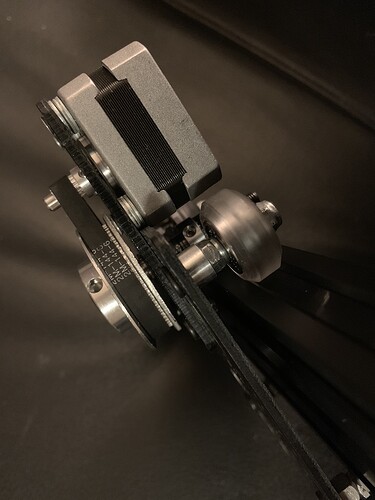

Just a rough sketch (3x Nema 14, 34x34x28, 1,2kg.cm + 48/12T pulley reduction)

I'll make 2 series of parallel 26650's, 5500 mAh. (It will give me ~7.4V, 11Ah)
I'll use 3x 14HS13-0804S (0.8A, 6.8ohms, 5.4V, 1.8Kg-cm) + 3:1 reduction ratio 16:48T pulley (5Kg-cm, I take off 0.4KG as friction caused by reduction)
Maximum load 5KG (I don't expect more than 3.5Kg, but I like to take margins)
Based on my calculations, single batterypack will give me about 3h work
Am I correct with the above?

I'll finish my project using steppers, because I want to try my theory :stuck_out_tongue:
Wireless motion and timelapse control (iFootage Motion S1A3) - YouTube - this thing uses steppers. I can see a lot improvements there while still using steppers.
After building first prototype X axis, I believe I can win the battle :smiley:
This little setup can handle double of weight that I actually need. It can handle 5D mark IV + EF 70-200mm + battery pack, up and down at 90 degrees.
The torque on idle (that came from pulleys reduction and belt friction) is enough to hold my weight at about 60 degrees, without powering up the motor.
The speed is more than enough for what this setup is designed.
No slop, no backslash caused by gearing :slight_smile:

Project done and am pretty much happy with the results :slight_smile:
With some serious reduction ratios, I could get steppers down to 0.5A / phase, so that single battery pack lasts for about 4,5h continous work.
Missing some screws and details (still in testing phase).
The best part of this project for me was the chellenge :sunglasses: I learned a lot.
