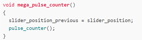

void mega_pulse_counter()
  slider_position_previous = slider_position;
  pulse_counter();

YOu appear to never set slider_position_previous to anything, so always zero.
Your slider_position_previous must declared with volatile keyword if it supposed to change inside an interrupt
Ok, but I don't think you want to be doing such things in an interrupt function. Do it in the main code.
Yea. You're right. I should move the slider_position_previous outside of the interrupt. Good point. Thanks.

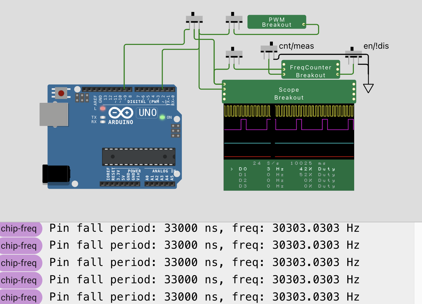

Timers.
https://www.pjrc.com/teensy/td_libs_TimerOne.html
#include <TimerOne.h>
// This example uses the timer interrupt to blink an LED
// and also demonstrates how to share a variable between
// the interrupt and the main program.
const int led = LED_BUILTIN;  // the pin with a LED
const int stepPin = 9; //
void setup(void)
  pinMode(led, OUTPUT);
  pinMode(stepPin,OUTPUT);
  Timer1.initialize(33);
  Timer1.pwm(stepPin, 512);
// The interrupt will blink the LED, and keep
// track of how many times it has blinked.
int ledState = LOW;
void loop(void)
  digitalWrite(LED_BUILTIN, digitalRead(LED_BUILTIN) == HIGH ? LOW : HIGH);
  delay(100);
(code dropped into UnoScope - Wokwi ESP32, STM32, Arduino Simulator and move the wire from pin 13 to pin 9.)
