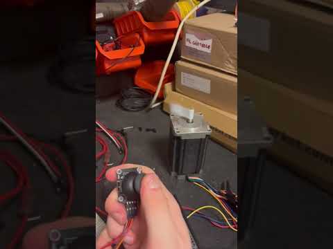

We are doing a project at school and I need to move the stepper motors with the joystick module. My motor is nema23, I use TB6600 as motor driver. I'm 99% sure my connections are correct. My code is as follows;

I'm also adding a video.
[Motor test1]
[Motor test2]
As you can see in the video, I'm trying to turn it right but sometimes it also turns to left.
I know it's a bit complicated, I can try to make it more precise if needed.
I am also adding the TB6600 motor drivers microstep settings
SW1- ON
SW2- OFF
SW3- OFF
SW4- OFF
SW5- OFF
SW6- OFF
Does it matter? or are these correct?
stepDelay is set to 50 µs, which results in a frequency of 10 kHz. Make sure your stepper motors can operate correctly at this speed.
As a start, set delay between step pulses to 10- 50 milliseconds.
Nema 23 tells nothing useful but a link to the datasheet does.
Increase the delay. Then try changing the pulse to HIGH/LOW without the initial LOW.
void stepMotor(int stepPin) {
    digitalWrite(stepPin, HIGH);
    delayMicroseconds(stepDelay);
    digitalWrite(stepPin, LOW);
Thank you for all the supports. I was sure about connections %99 but that %1 broke my system. I tried to change step motors cable and it fixed :sweat_smile:.
