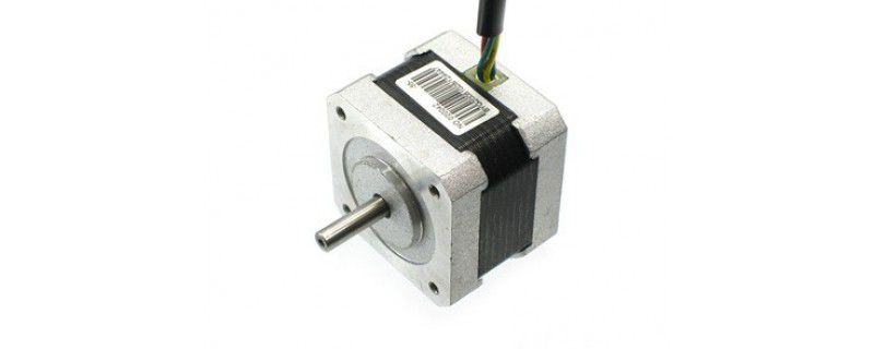

I have a stepper motor from a printer teardown I did, but I do not have a shield with the arduino that I can use to run it with. I want to run the stepper without using any sort of shield. Is this possible without damaging the arduino? It is a 4 pin stepper by the way. Thanks!

Its the datasheet for the motor. It says it runs at 24v, and 600 mAh
Bipolar 4-Wire
Google "stepper motor driver 24V ,600 mA"

You can use an L293D and apply 12V with no risk.
L293 can operate with a supply voltage up to 36V (see attached datasheet)

There are two separate coils in a bipolar motor. The leads are the ends of the wires that form those coils; there is no positive, negative, signal, whatever. Think of it as two separate electromagnets inside the motor where each electromagnet can be fed current in either direction to push or pull the rotor of the motor.
With respect to drivers, you'll spend much less money and have a much easier time using an A4988-based driver.

You forgot Motor Power, which is a SEPARATE (from the 5V) power supply.
You cannot run the steppers from the arduino 5V.
