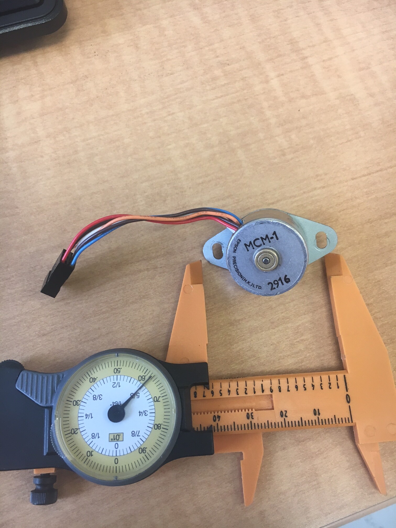

My teacher gave me an Epson, MCM-1 Stepper motor with 6 wires. I haven't been able to find anything about that particular motor anywhere. Has anyone heard of or used this motor? really anything will be helpful.

My expectation is that it is a motor that can operate either as Unipolar or Bipolar. I would expect each coil to have 3 connections - one in the centre and one at each end. This can b verified by measuring the resistance.
If I am correct it is probably easiest to treat it as a Bipolar motor by ignoring the connections to the coil centres.
As well as reporting the resistance measurements can you post a photo of the motor with something to indicate its size.

Here's a picture. The six pin connector is something i haven't seen before either
Image from Reply #4 so we don't have to download it. See this Image Guide

I measured the resistance and found the 2 center tap wires and the coil ends. I now know the sequence for clockwise and counter clockwise

I assume the two center-tap wires are NOT connected to each other. They must be separate for the motor to work in bipolar mode.
You did not tell us what resistance measurement you got.
What stepper motor driver are you using?
From a different perspective entirely, and because your motor is so small, I wonder would it work as a Unipolar motor if the two centre-tap wires are connected and you use a ULN2003 chip as a driver. Look up the many Arduino threads about 28BYJ stepper motors. (I don't have any of them myself).

they measured 1.2
and the coil ends are 2.4.
I used a battery to find out the pin sequence for clockwise and counter clockwise.

I suspect such small motors can only take a small current and if the coil resistance is only 2.4 ohms that means using a very low voltage unless you use a stepper driver that can limit the current to protect the motor.
