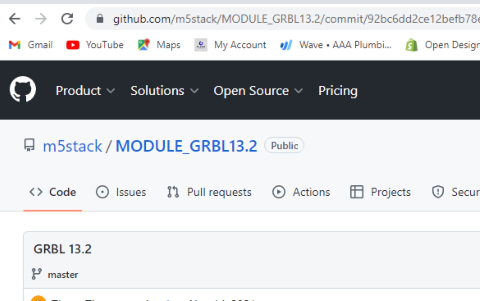

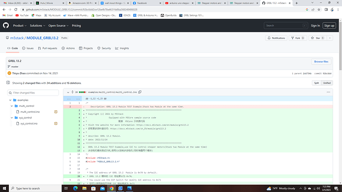

@ballscrewbob here is a screen grab of what i downloaded and had my arduino uno, cnc shield v3 and drivers running things until i managed to figure out the grbl 1.1 "well i was helped on this forum for the right direction".
GitHub - m5stack/MODULE_GRBL13.2 isn't grbl. It is something that talks to grbl. ???

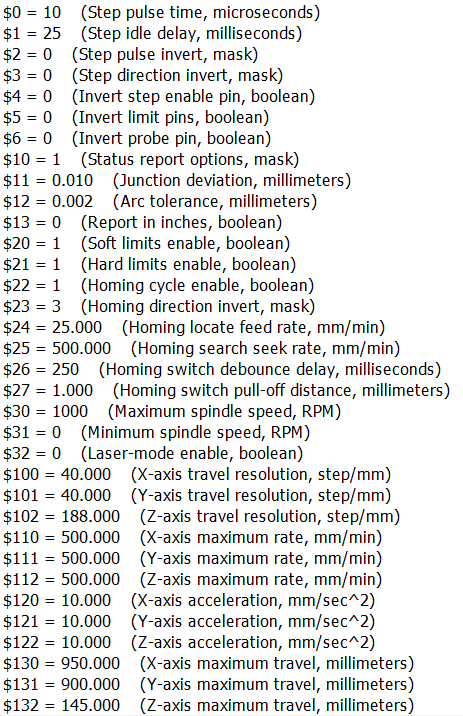

Your current steps look out of whack $100-102
The acceleration figures also look slightly low $120-122

@Ballscrewbob i changed the $110 $111 and $120 $121 and that solved the speed issue but gave me another of the y axis steppers turning at a different rate of speed, 3 to 1 difference in ratio. jumpers are exact double checked wiring, connections exact same power rating through both drivers.
You can either calculate the exact step figures and there are a few methods online for that.
I found it easier to use a digital Vernier myself.
Simple did an axis move of 10 mm and measured it.
Then I simply added steps or removed them on the appropriate axis.
Usually they are multiples of the original value eg. if you have only 5mm movement for a 10mm step and your value is 400 then another 400 to make it 800 will correct it.
