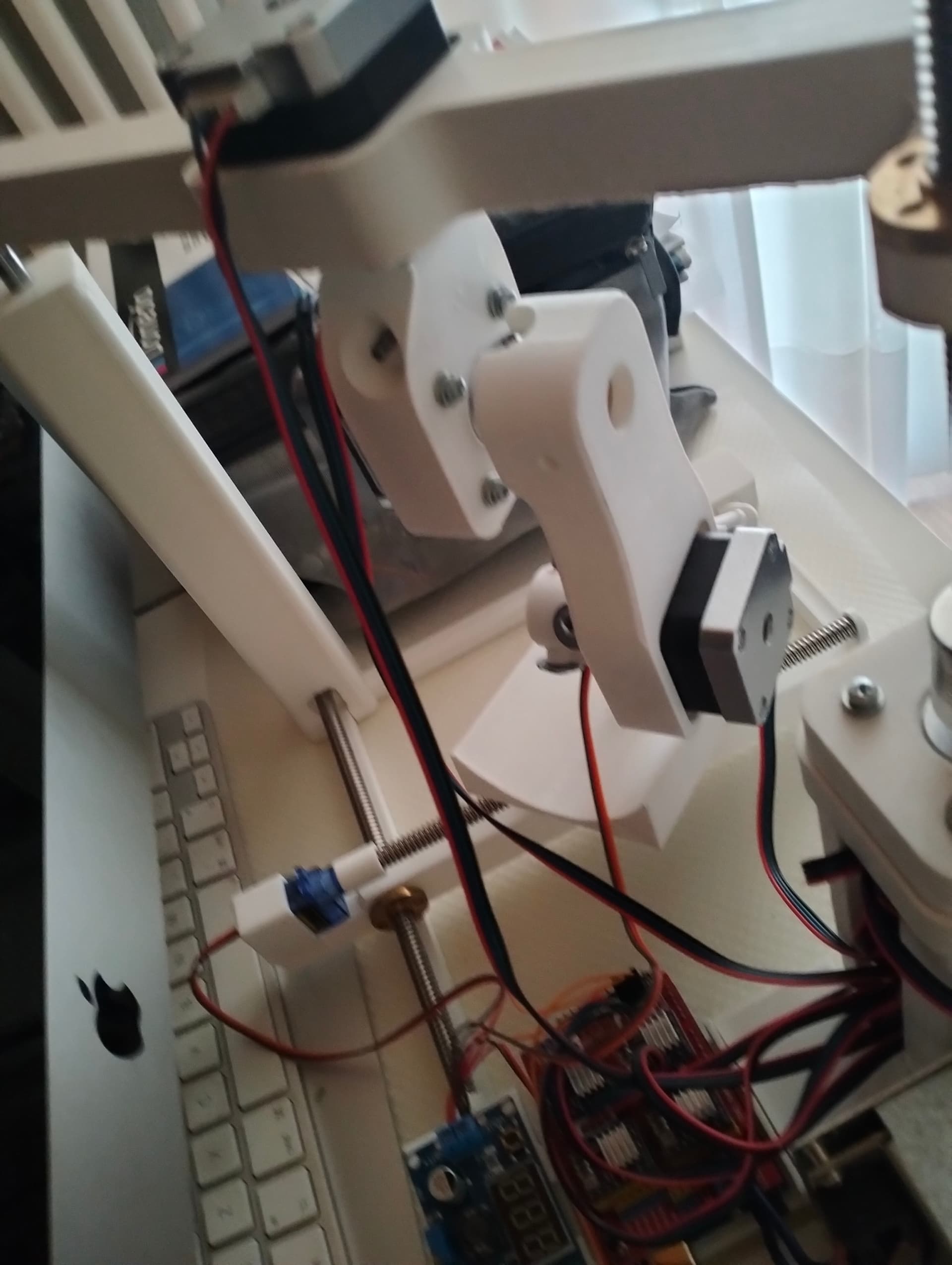

I am building a 7DoF robot with servos and steppers. I wrote an Arduino sketch to move the motors and a GUI on Processing to control them with sliders.
I can not make the steppers move as I want: sometimes they move, sometimes they dont, sometime they move more than they should or less than they should and I cant understand why.
From the processing GUI, arduino receives the input of the degrees to rotate from the current position (im sure this works as you can see in the first photo).
Then I calculate the corresponding steps (im using 1/16 microstepping) and I call the function "stepper.move(steps)" and, if distance to go is different not 0, i call "stepper.run()" in a while loop.
I don't understand why it does not move the exact number of steps I give as input to "stepper.move(steps)".
I also tried with "stepper.moveTo(steps)" but I encounter the same problem.
pls help as soon as possible
thank you in advance.
Here is the photo and the codes:

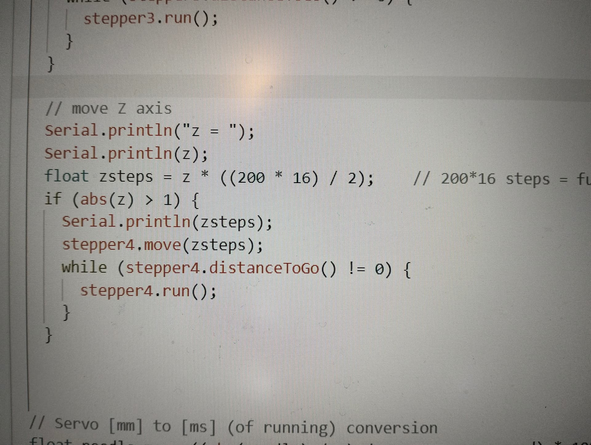

    float zsteps = z * ((200 * 16) / 2);    // 200*16 steps = full rev = 2mm
    if (z > 1) {
      stepper4.move(zsteps);
      while (stepper4.distanceToGo() != 0) {
        stepper4.run();

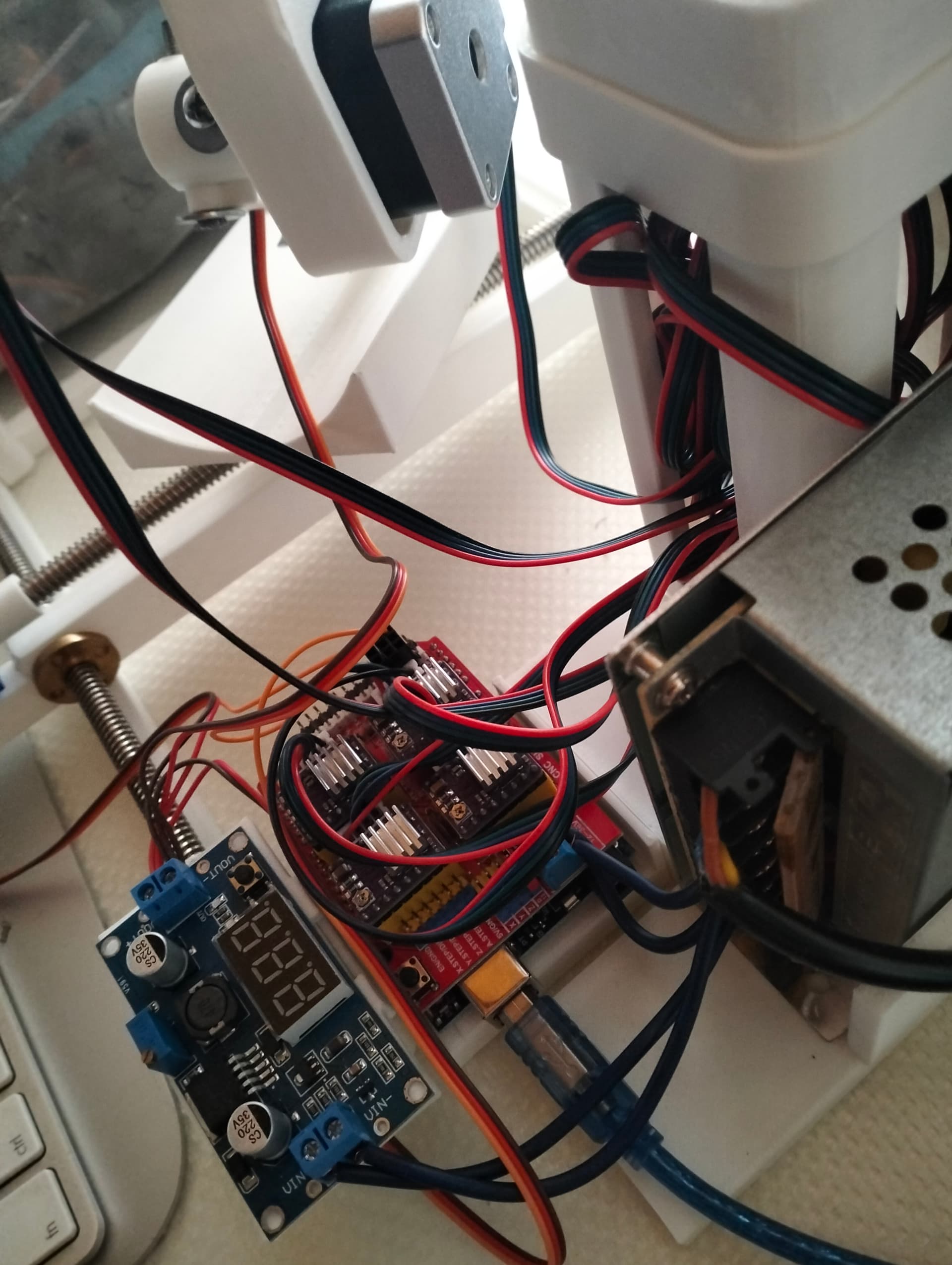

Usual problems are wiring and insufficient power. Show your wiring diagram and power source.
Im Sorry but I dont think that is the problem since for certain step values (most of them actually) the motors move 100% of the time.
I believe I have a problem with the step value I give as input to stepper.move(stepvalue)
Anyway here are some photos of the wiring. I am using a 12V 10A Power supply and I am quite sure It Is enough.

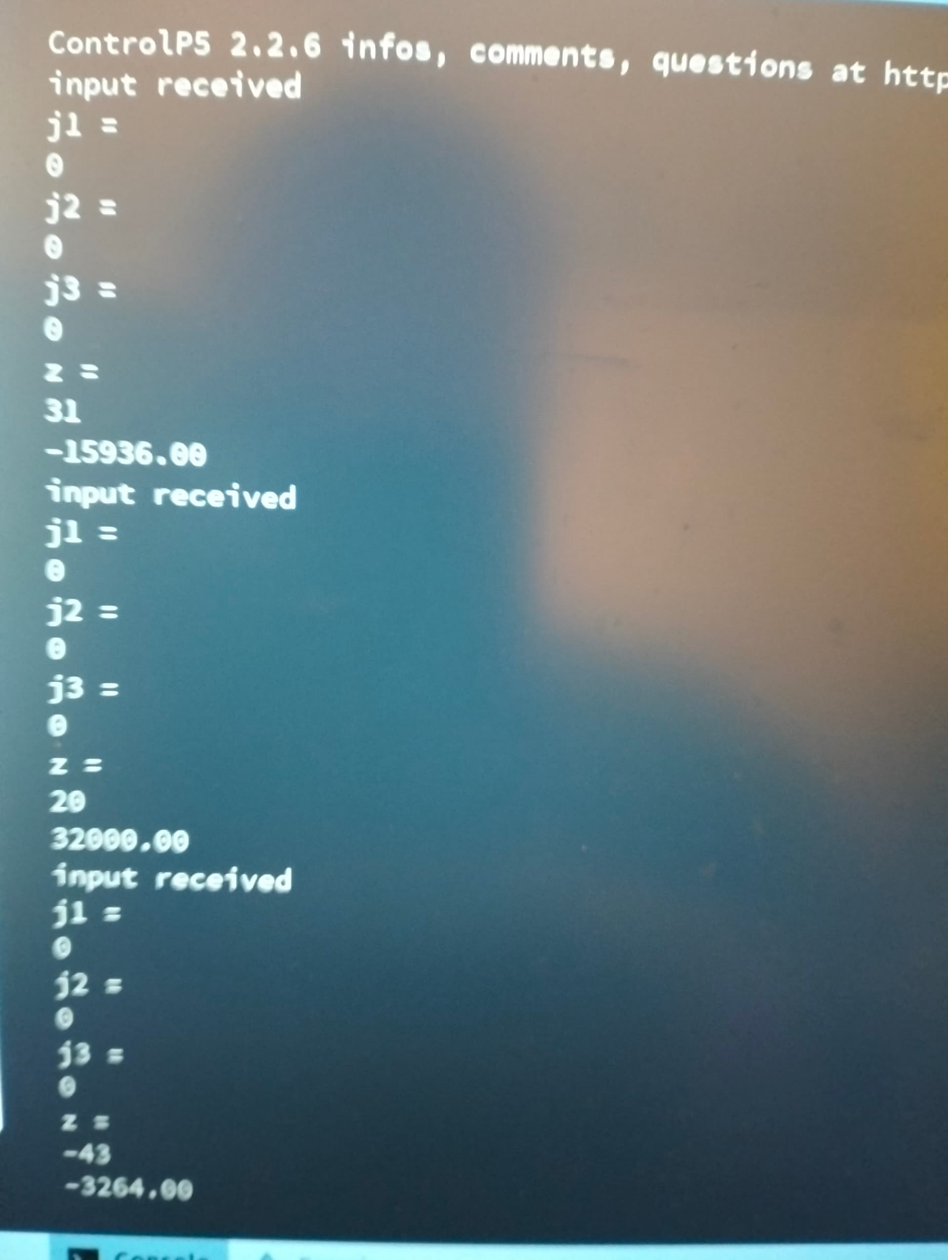

Ok. Thanks for the missing pieces.
I found where the problem is but I cant understand why this is happening.
Its a pure programming problem.

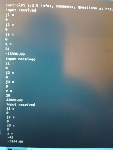

As you can see the problem is the calculation of zsteps. Sometimes the signs of z and zsteps are not the same.
I thought It was an overflow problem but the float type has much more digits available to handle the small values of z I give.
Basically that formula is doing: (z * 1600).
What is happening??
int z = data.substring(0, data.indexOf(',')).toInt();
Since z is in an int, the calculation above is done with integer math, and it's only when the result is assigned to zsteps that it is converted to a float.
On an Uno, an int is 16 bits, with a range of -32768 to 32767
Ignoring overflow, the value of z * ((200 * 16) / 2) when z is 31 is 49600. This is outside of the range of a signed 16 bit integer and gets interpreted as -15936 (49600 - 65536).
Force the calculation to use float math to avoid this.
float zsteps = z * ((200.0 * 16) / 2);    // 200*16 steps = full rev = 2mm
Thank you so much!
This was the solution!
I knew It was something to do with integer max values but I didnt know I had to force float math before assigning float type.
