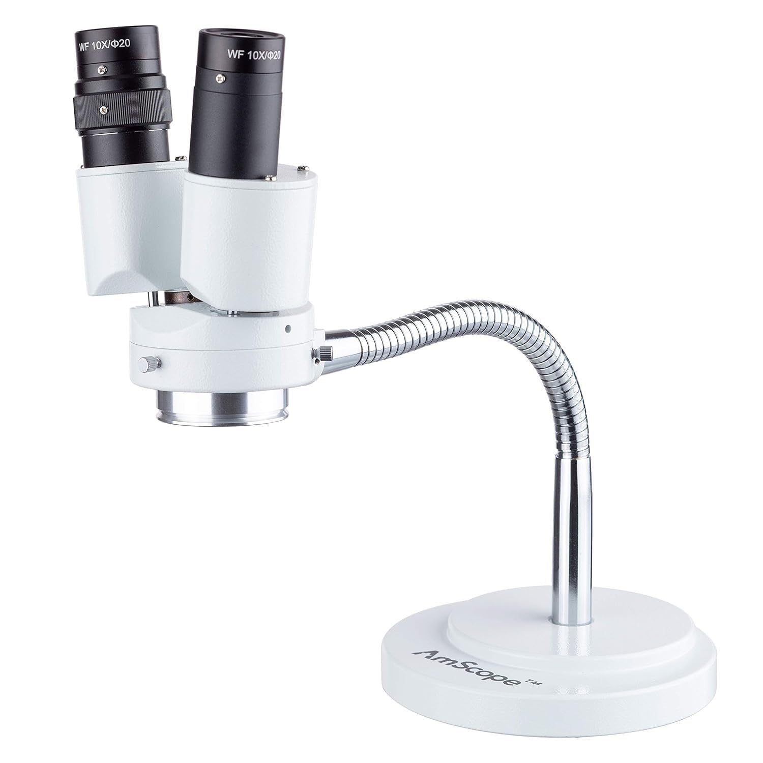

Does anyone use these types of microscopes: AmScope [SE508](https://www.amazon.com/AmScope-Magnification-Binocular-Microscope-Revolve/dp/B0859VNPJB) 8X Magnification Binocular Stereo Microscope and AmScope [SE400](https://www.amazon.com/AmScope-SE400-Professional-Microscope-Magnification/dp/B005MZB5NE) 10X Binocular Stereo Microscope? Which one is more handy for DIY electronics work, small item repair, soldering, inspection?

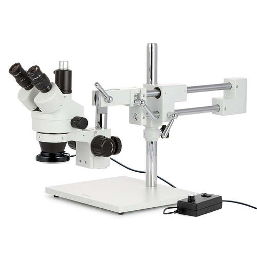

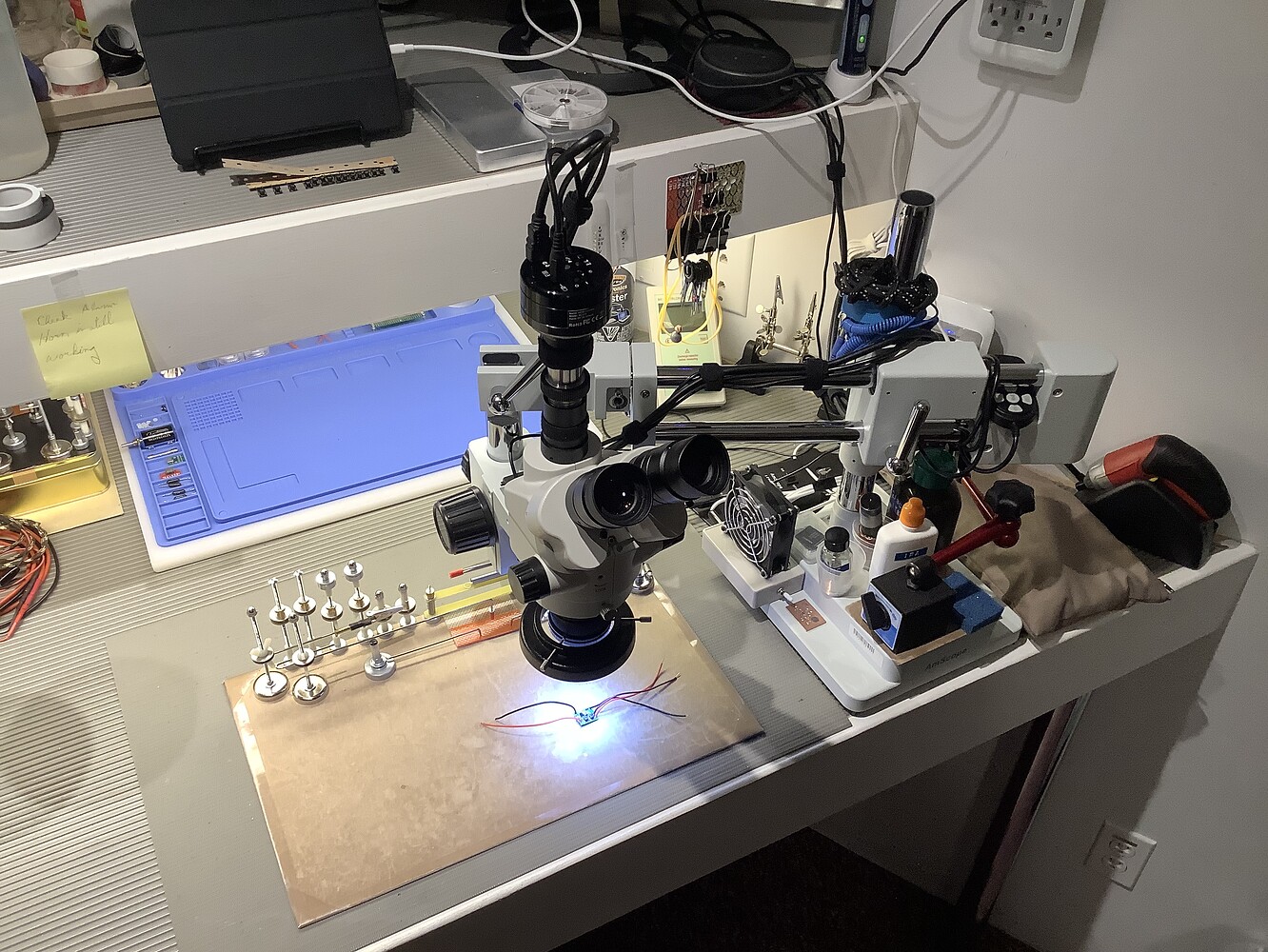

- I use the AmScope SM-4T Series Trinocular Simul-Focal Zoom Stereo Microscope 7X-45X

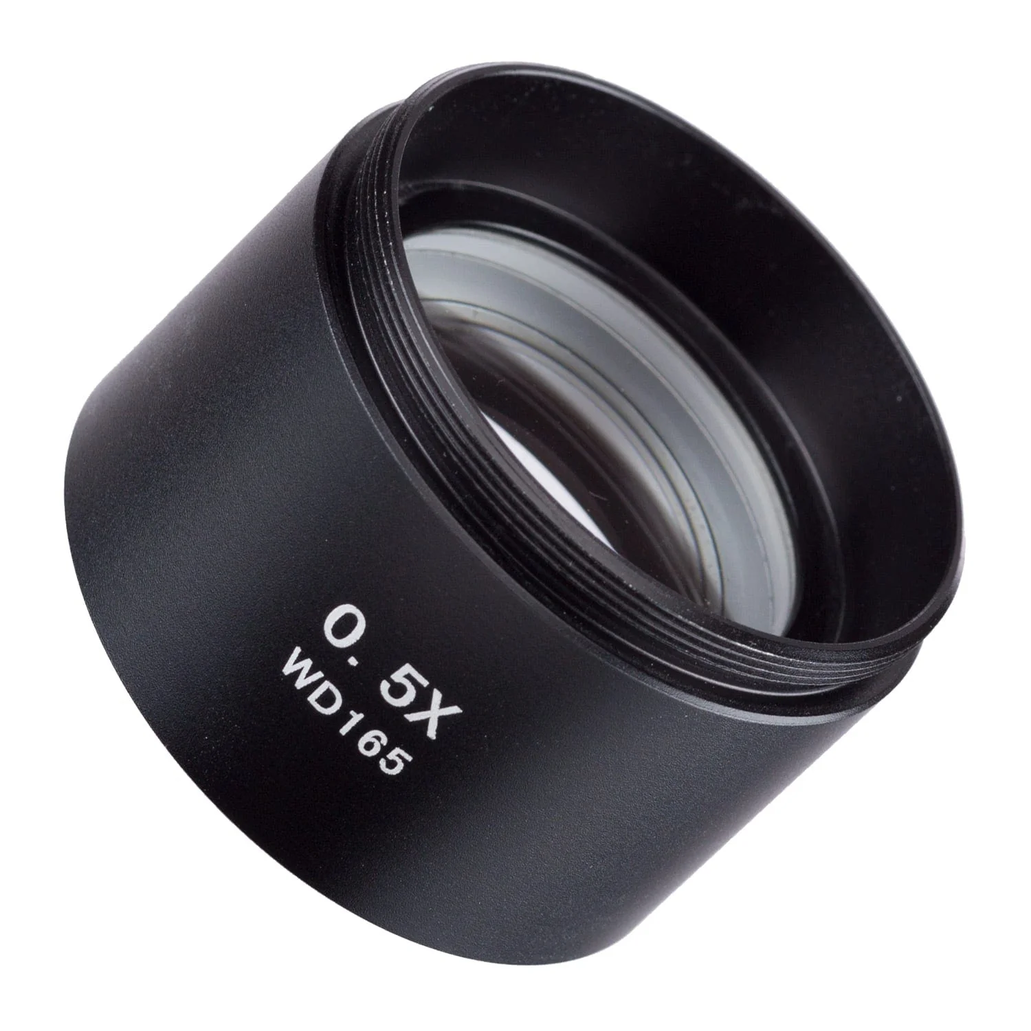

- The terminology one should look for is:
Trinocular
Simul-Focal
Zoom
A .5 Barlow lens is a recommended addition.

The type like AmScope SM-4 Series is overkill for me, the price is too high.

- 8X might be a too much for your application.
- Zoom control is a must.
- Get a LED adjustable light source.
- If you ever need a VGA monitor, get the Trinocular Simul-Focal version.
- However, budget is important, maybe save up a bit longer 🤔

- 8X would be good for looking at fine cracks on PCBS.
- For soldering, 0603 to 1206 or larger I use the Zoom capability about 2 to 7.5
- The focusing of the second microscope you show is (sorry to say) quite Mickey Mouse. 🥺

Depending upon how old you are you might do well to just get a visor magnifier.
The unit with only the gooseneck could be a challenge to set up depending on distance to work. I suspect that it will sag and require frequent compensation.

Nice setup, I see. I'm now thinking about my microscope upgrade to SM-4TP. Which camera you have on yours? Are it is something special or general cameras from Ali will fit?
