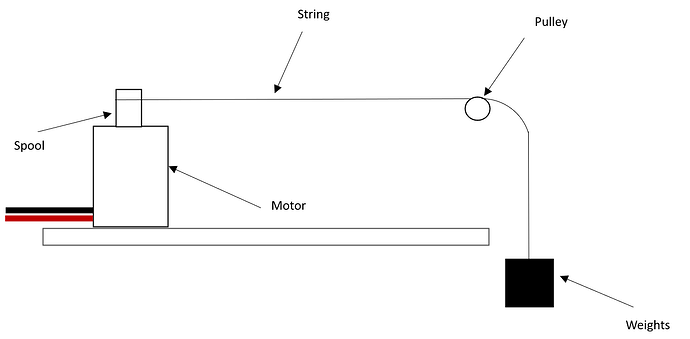

I'm using an Arduino Uno, a DBH-12 Dual H-bridge motor driver with a 12v dc motor. There is a spool on the motor shaft and when the motor is being driven, a string is being wound around the spool. The string is at the same time being run over a pulley and pulled in the opposite direction by weights hanging off the table. When I stop the motor, I need the motor shaft to have as little friction as possible so that the weights can pull on the string and unwind the spool fully. However, when I stop the motor, the shaft of the motor is hard to spin as it's magnetised (I think) so the weights can't fully unwind the spool. I've used a multimeter on the output terminals of the motor driver to see if there's any voltage when I stop the motor. The multimeter shows 0 volts but for some reason the motor shaft is hard to spin (so there must be current running to the motor?). When I completely disconnect the motor from the driver, the shaft becomes easy to spin again. Why is the shaft hard to spin even though the driver is providing 0 V? I can't keep physically connecting and disconnecting the motor from the driver so it would be nice if I can completely demagnetise the motor to allow it to freely spin using code. I could also use a relay but it would also be nice to not need more hardware to do this. Here's the code I'm using to stop the motor:

Here's a sketch of my setup:

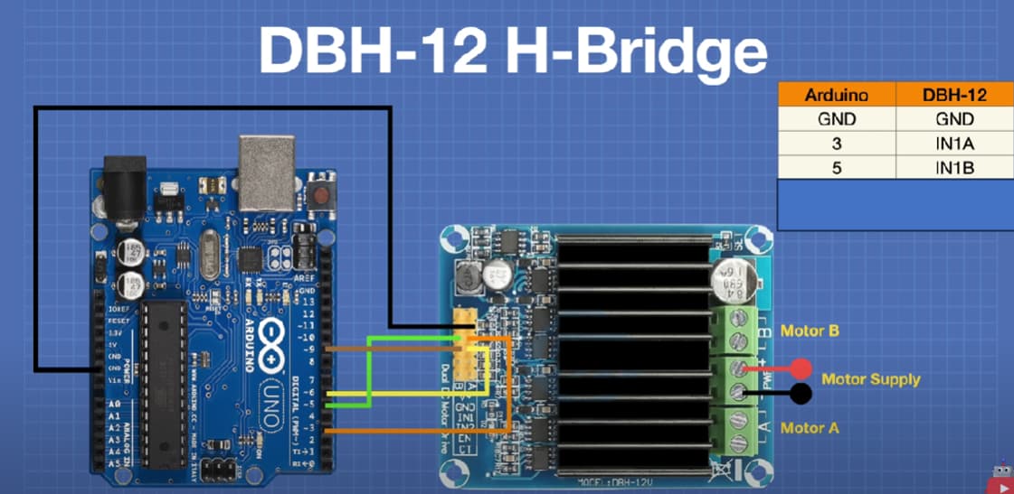

Wiring:

When the motor driver is commanded "stop" it likely short circuit the motor windings and that acts as a brake. Is there an ENABLE input on the driver that You can deactivate at stop?
Increasing the diameter of the spool is one option.
Yes, there is thanks
Code:
#define IN1A 3
#define IN2A 6
#define EN 9
analogWrite(EN, LOW);
Connect EN input on driver to pin 9
