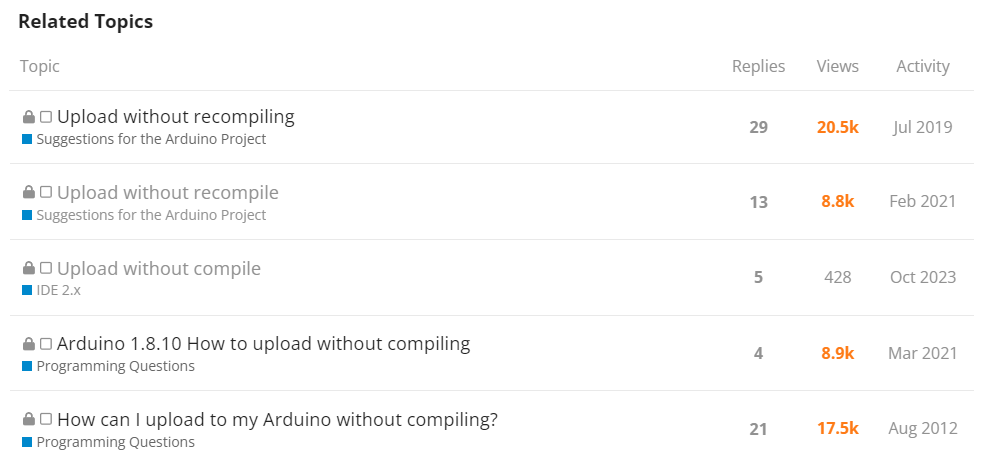

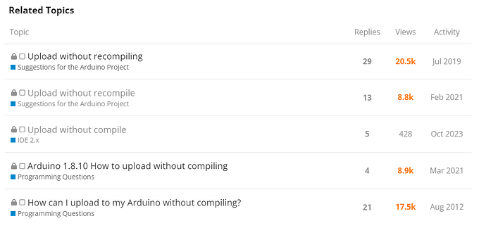

To what you base that there is not much request. Old threads about this feature had collected about 60k views. If no one care and want it why those threads are so popular and why it pops up again and again? My theory is that quite many try google it and land to those threads.
