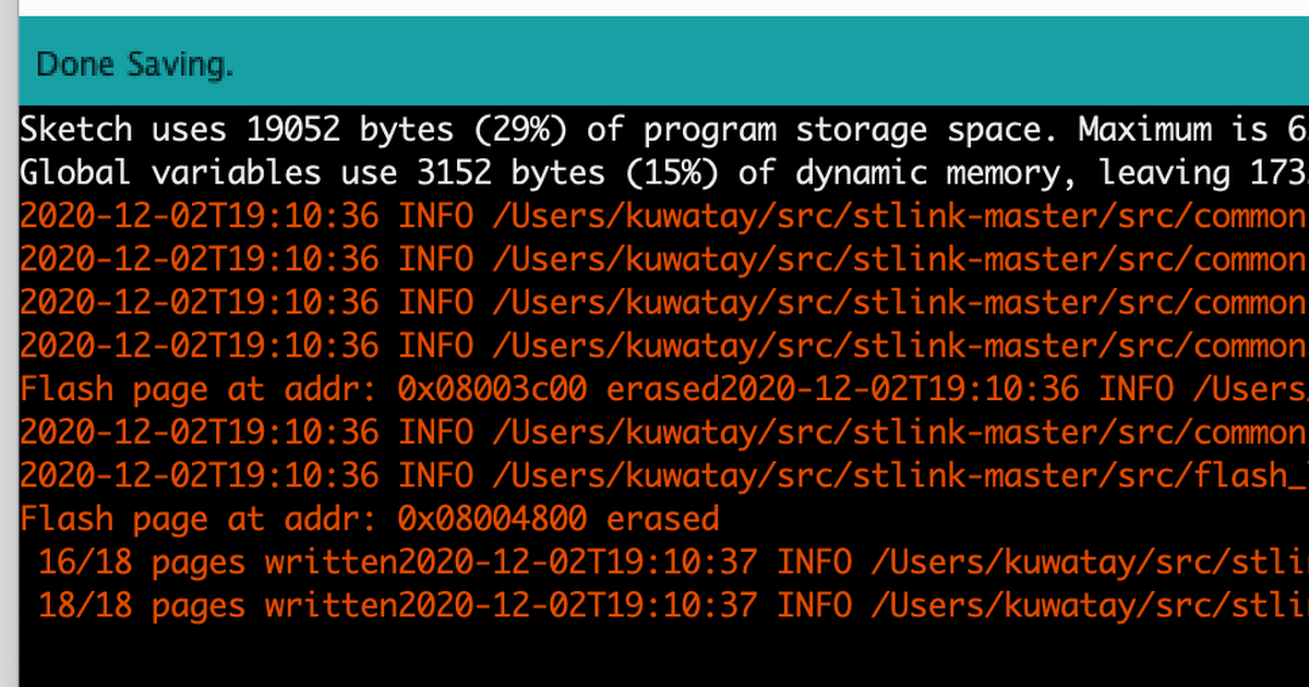

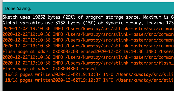

I don't know about that, I ran a servo motor and blink program with the same configuration. The sketch flashes:
It may run once, but after a reset or re-power I would be surprised if it did. Try both jumpers towards the USB connector.
