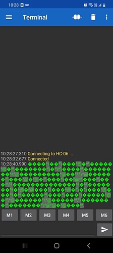

greetings, I am measuring rpm in a motor by means of the pulses of a hall effect sensor, I am using a stm32 Nucleo F411RE and I want to send the data to the cell phone using the hc-06 bluetooth module, however, the data I receive are random characters, could you give me an idea of what is happening?

Are the baud rates the same, that is what you see if they are different. I assume mySerial is the bluetooth connection and it is set to 38,400baud. Make sure the phone is also 38,400baud, I have no idea how to do that.

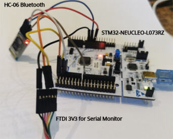

cannot find my stm32 Nucleo F411RE but did find some results for a HC-06 connected to Serial1 hardware port of a stm32 Nucleo LO73RZ (which has a similar pinout to the F411RE)
code (tools>Board set to Nucleo-64)
// STM32 Nucleo-LO73RZ board serial1 to HC-06 Bluettooth Classic module
// HC-06 TX to STM32 D2
// HC-06 RX to STM32 D8
// HC-06 VCC to STM32 5V GND to GND
// Serial is to pins D0 RX and D1 Tx NOT USB
// connect FTDI USB-RS232-3v3
// orange to D0 RX
// yellow to D1 TX
// black to GND
// Serial1 mapped to RX D2 (PA10) and TX D8 (PA9)
HardwareSerial Serial1(PA10, PA9);

I first tested the Serial1 by connecting D2 to D8 for a loopback test - all OK
then connected HC-06 (baudrate 9600)
paired Android phone with HC-06 OK and ran Terminal app which connected OK

Android Terminal app displays
