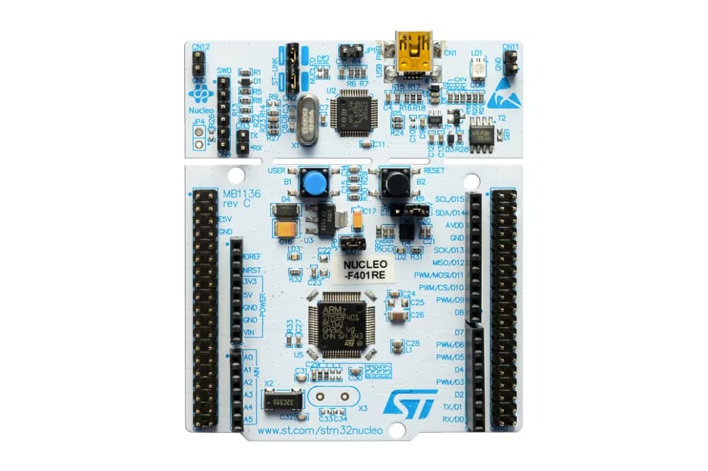

Greetings, I have a question about programming the NUCLEO - F411RE board with the arduino ide, I want to get the full potential of the board and I don't know if programming it in the arduino ide limits it instead of programming it with CUBEide.
I have used both - CUBEide probably gives more low level control but Arduino IDE works OK, e.g. three phase square wave

what do you want to do?
If You want to use Arduino then use the Arduino environment.
If You want to use an STM32 You need to use and learn the ST environment.

Hi thanks for your answer, right now I'm going to use it for normal purposes as an arduino but I expect to have a higher performance, readings sensors signal, transmiting those signals, do you think that stm32 can use all its capability with Arduini ide?
PD: I'm reading a square signal with stm, with cube ide is so necesary too use the timers but I receive it with a tipical arduino code, so it call my attention the libraries you are using where do I get them? is there material to study and use with stm32 and arduino ide?
Yeah, cubeide gives more access to all stm32 functions but I want to know if programming stm32 with arduino ide makes it slower or does not let to give all its potential for the taks that I'm going to program in it
There is a common saying among software developers:
Premature optimization is the root of all evil.
It is very likely that you will be able to accomplish your projects using the Arduino framework via the "STM32 MCU based boards" platform (AKA "STM32duino").
STMicroelectronics provides resources for the development and maintenance of this platform, so although it is a project of the Arduino community, it is far beyond a simple hobby project.
This platform is very popular and used by many members of the Arduino community. It has been used to make incredibly advanced projects.
So if you want to use the Arduino framework with your board, then just go for it.
Conversely, if you prefer to focus on learning how to use the closed source STM32CubeIDE, or PlatformIO then I'm sure you will be happy with those too.
depends on your project requirements, e.g.
what sensors? what data acquisition rates? etc
you mention transmitting signals - how? WiFi, LoRa, NRF24L10, etc?
install the Arduino core support for STM32 based boards as referenced by @ptillisch and experiment with your STM32 Nucleo dev board, e.g. run some of the example code
give us the requirements specification for your project?
using the Arduino framework can make it simpler to port code to other microcontrollers, e.g. recently ported a project from a STM32 to ESP32 which is also supported by the Arduino IDE
