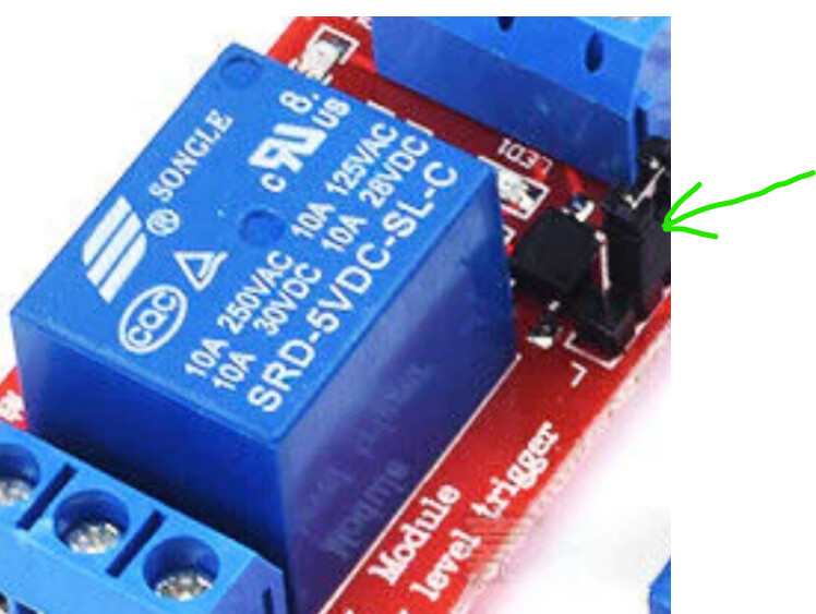

I have also attached a screenshot of the relay module for reference
Sir, I am only using a relay module for switching the AC solenoid valve, and an HX711 amplifier module to interface the load cell with the MCU. I have provided separate power supplies for the relay module and the HX711 module.
The ground wires of both power sources are connected to the MCU (common ground). The load cell wires are also shielded to reduce noise.
I have attached a screenshot of the relay module for your reference

I would assume the relay in the photo is maximum 10amp resistive load
for an inductive load 2 to 3 amps maximum
the relay is labeled 5volt - the STM32 uses 3.3V logic - how do you drive the relay?
I am using an extension board. I have plugged the 5V DC SMPS into it, and I am also plugging the AC valve wires into the same extension board
Sir, I am supplying 5V DC to the relay from a 5V DC SMPS. I have connected the relay’s DC- and DC+ pins to the SMPS, and the signal pin of the relay is connected to the STM32 development board
It would be more correct to remove the jumper and connect the center pin to your MCU 3.3V supply.
Yes, I have tested the relay without connecting the AC valve, and it switches perfectly.
Which jumper wires are you talking about? Do you mean the jumper wire on the relay module
Jumper, not wire.
