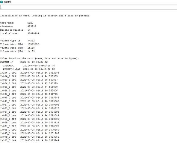

I now have an SD card module which I will use, the first version rather than sending the images over BLE, I will upload the images onto the SD card and have the classifier read the images from the SD card. Let's see how it does, if the results are good I will look at sending the images to the board via BLE and have the classifier process them.
Getting there.
(Images are not actually that size in the application they are reduced to 100px x 100px)
